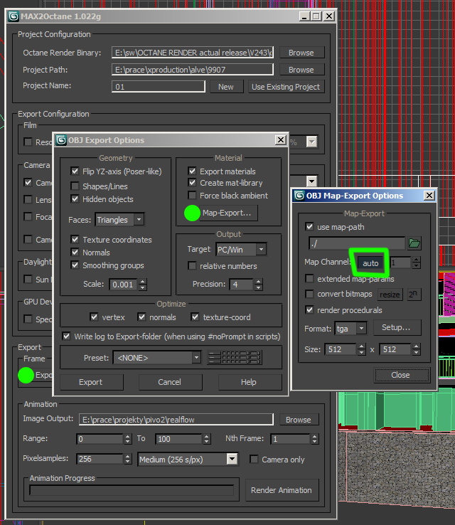

you must turn enable "auto" map channel in export plugin.
