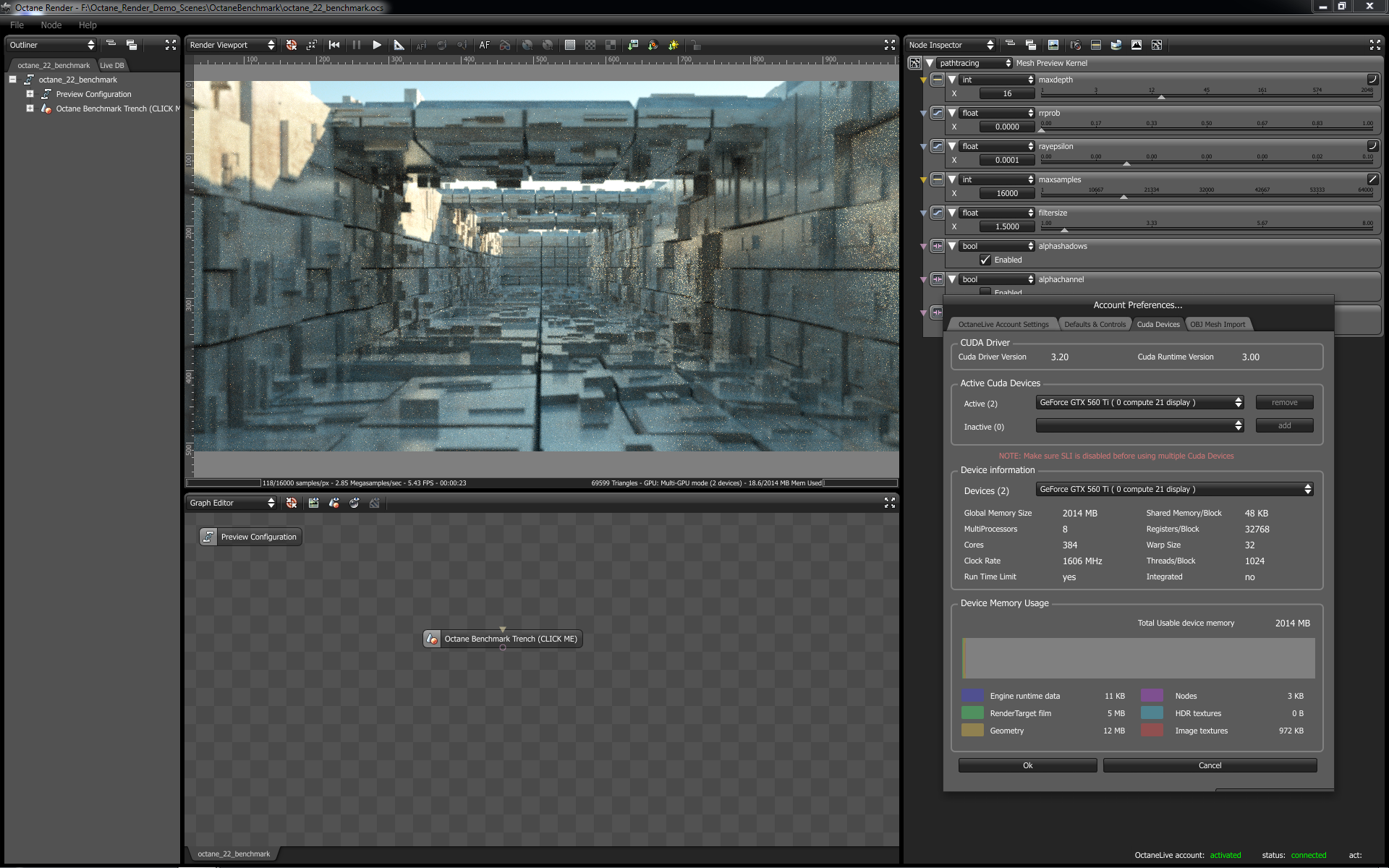

Not all cores are being used
, however glad i could help. Also, promised I would produce these results anyway

Ahhh.... it's 6.86 megasampels/sec for the 560Ti against 5.7-5.9 megasamples for the 460 in direct lighting.That sounds more like it.The extra speed is scaled correctly and is accounted for by the 48 extra cores and increased 100-200mhz GPU speed.
CPU:-AMD 1055T 6 core, Motherboard:-Gigabyte 990FXA-UD3 AM3+, Gigabyte GTX 460-1GB, RAM:-8GB Kingston hyper X Genesis DDR3 1600Mhz D/Ch, Hard Disk:-500GB samsung F3 , OS:-Win7 64bit
Hi, Jaberwocky dancer.
The problem is that it isn't utilizing all its 384 cores if i'm right, Since 256 are being put to use. Therefore I believe that when the full potential is utilized we can expect a raw 3.2 mega-samples on path-tracing during the execution of the bench test.

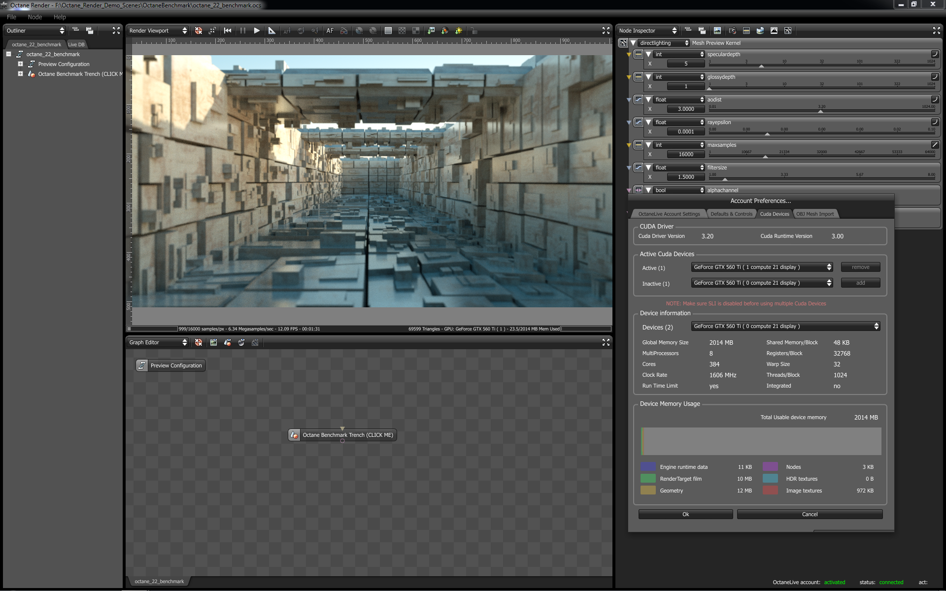

I must did something wrong, because the bench march test in my machine doesn't render with any reflection. This could explain the high megasamples. I have to retry this again.

Ok this is embarrasing, but what I suspected was right, I accidently (for lack of knowledge) pressed the colored clay render (probably from fiddling with the control while testing it and before loading the benchmark scene). Sorry for the confusion
. Will post my screen grabs later.

here are my screen grabs. My question is, how come it's much slower than what bluebread is getting since all 384 cores are running? and when I am using both cards it only show 384 cores and not the additional cores of the second card but jumping a significant number in terms of megasamples.

I think the problem with the speed on the 560TI will be related to the speed problems on the 460.That is the GPU design Looks like the 560TI uses the same number of Warp schedulers as the 460 (EG 48). the GF114 GPU in the 560 is a mod of the GF104 GPU found in the 460, only with the missing block of Cuda cores now enabled.I think there is a Data Bottleneck.It my be interesting to compare it to the 570 which uses a different GPu design with More Warp Schedulers.
