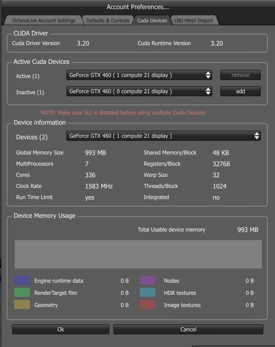

hi Octane team,
I made a test scene for octane render, and it worked well in direct lighting mode.
But my graphics cards crashes every time when i switch to path tracing mode.
Please help me solve this problem, thank you.
Link to the files:
http://hotfile.com/dl/106987230/7e712f9 ... t.zip.html
Octane Version: beta2.43
windows 7 x64 CUDA3.2 Forceware 266.58
Hardware
i7 [email protected] 16GB DRAM
MSI GTX 460 1GB Hawk
Sparkle GTX 460 2GB
SLI disabled

Thank you for your testing. :)
Yeah I've already used one gpu each time for rendering.
And even the 1GB one lived longer than the 2GB one(about 2 sec longer LOL).
I found out that lower the maxdepth value of path tracing helped a little, but still unstable.
BR
akira.
