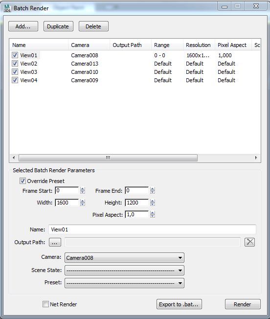

Elvissuperstar007
Posts: 2604
Location: Ukraine
this is the principle (3ds max)

Elvissuperstar007
Posts: 2604
Location: Ukraine
I was not interested in animation, I'm interested in Batch Render! to work with for interior

matej
Posts: 2083
Joined: Fri Jun 25, 2010 7:54 pm
Location: Slovenia
Elvissuperstar007 wrote:I was not interested in animation, I'm interested in Batch Render! to work with for interior
Prepare your different shots of the scene in separate .ocs files and render them from the command line through a simple python script.
EDIT: Forget Python, a .bat file with octane command line instructions will do just fine
