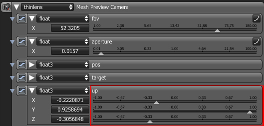

Hi Sam,
the problem is after exporting to Octane the navigation (camera orientation) does not work as expected. So if you turn the view (camera) to one side it tilts up or down because the camera up vector is not (0,1,0) or (0,0,1) as usual.
This will probably affect orientation and direction towards the sun lighting as well.
Please have a look the Vector values of the camera-up in the attached file.
Thank you.

Refracty wrote:Hi Sam,
I guess the question is: what is expected? The camera up vector in Octane should match exactly the camera up vector in Rhino at the time of export (try introducing some roll or "dutch" into your camera in Rhino) for any 1 frame.
Depending on the view settings in Rhino, the camera is usually locked to maintain the same amount of roll as you navigate about in relation to world Z, so the camera up vector is constantly changing. This is not true in Octane, which maintains a static up vector. So when you start moving about in Octane, things get skewed quickly.
It is easy to drop the camera up info coming out of Rhino so that it is always 0,1,0 in Octane, but then you lose any camera roll information. I will look at remapping it coming out of Rhino so it is always in the same wZ (in Rhino) plane as the target point, not sure that will be any better but worth a shot.
Sam

I thought that the camera roll is usually fixed to zero because you usually don't want to roll / tilt the image while navigating. But maybe I don't understand the Eula system correct.
But I think what you mean is that Rhino uses a lokal UP vector and Octane a world based and thas causes interpretation differences while exporting.
I am a bit confused, but in non technical terms: I just would expect to navigate in Octane the same way like in Rhino after exporting a shot.
Would be great to have a 0,1,0 Up vector in Octane after exporting.
Thank you Sam

OK, I'll add to the wish list add an option to drop camera up info and replace with 0,1,0. This would mean that any camera roll in Rhino will be lost if this option is selected.Refracty wrote:Would be great to have a 0,1,0 Up vector in Octane after exporting.
Sam
