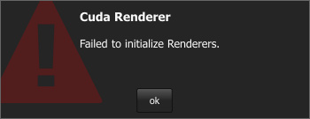

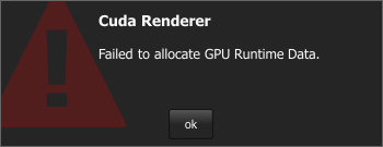

2. Currently, there seem to be issues with changing the Mesh Preview Resolution.
It seems that if you change the X resolution, tab, and then change the Y resolution, there are many times where it doesn't take the change in the Y (or worse, Octane refuses to work anymore). For example, the default resolution is 1280 x 800. If you need to change this to 800 x 600 by clicking on the Mesh Preview Resolution icon, entering 800 into the X resolution, hitting the tab key, and then hitting 600 in the Y resolution, there are many times when Octane won't take the change in the Y resolution (and the image will then end up as 800 x 800). As a matter of fact, if you make the changes fast enough, Octane will stop functioning properly or you can end up getting "Cuda Renderer" errors (see below).
It seems that the only way to change the resolution without issues is to first enter the X resolution, hit Enter, wait a few seconds for Octane to successfully make the change, and then enter the Y resolution and hit Enter (in other words, you need to do it as two separate actions).

Error #2 Received After Changing the Image Resolution

Error #1 Received After Changing the Image Resolution
