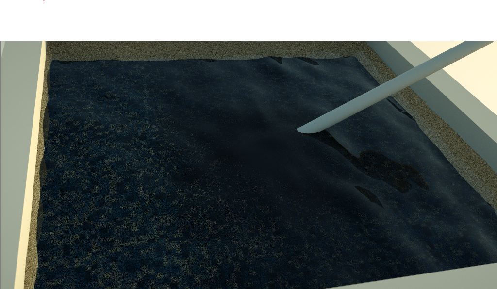

Hi
after few hours of researching of water material i got nothing
my water material looks f***** up (check pict,also glass material for windows,doors etc. have same effect)
can someone please explain settings for water material in octane
btw i have v1.0 beta 2.2 (demo)
Thanks!!!

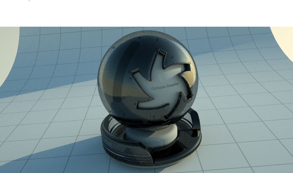

Edit: one more test glass
whatever i do object behind glass is black or very dark
water,glass material
The sun goes not through the glas.
Use a HDR-Background and Pathtracing.
The watersurface should also be closed, not only a plane.

yep with pathtracing looks much better, thanksface wrote:The sun goes not through the glas.
face
but how much is slower rendering process when i change from directlight to pathtacing???
A good question, maybe factor 2-3, against from the number of maxdepth...

Maybe you can reduce the maxdepth to 3 or 4...

Ok 2mio polys aren´t a few.
Maybe you can cleanup your scene, that would speedup it too...
