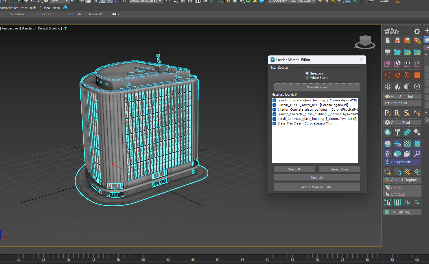

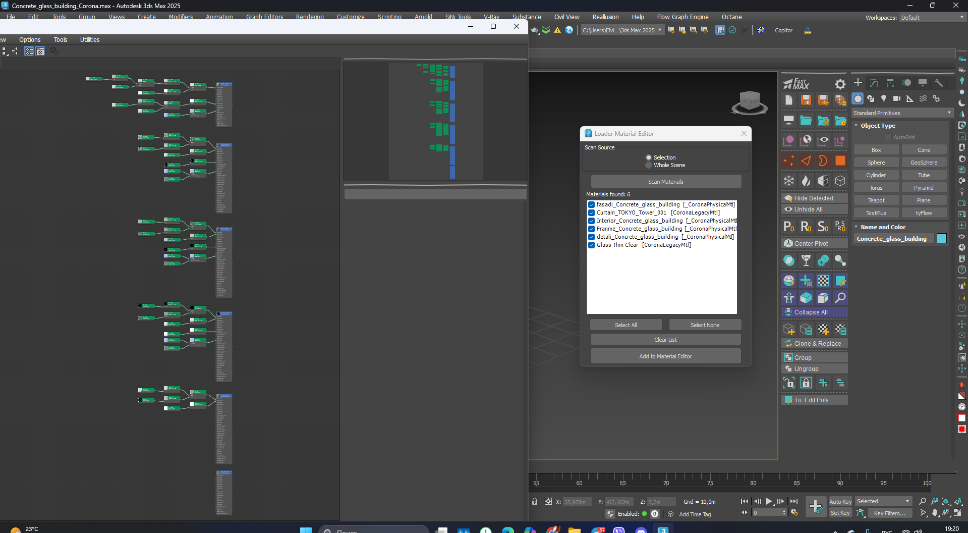

Added another script to auto-load assets from the scene.
