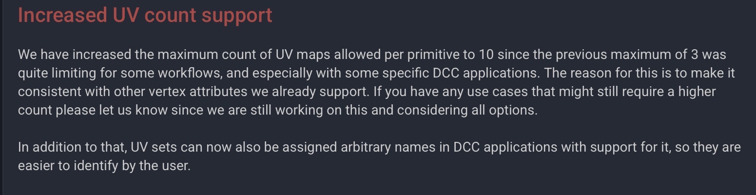

Hi guys,
In OctaneRender 2027.1-Alpha 1, the number of uv-sets supported has been increased to 10:
viewtopic.php?t=85551 Happy GPU rendering!
