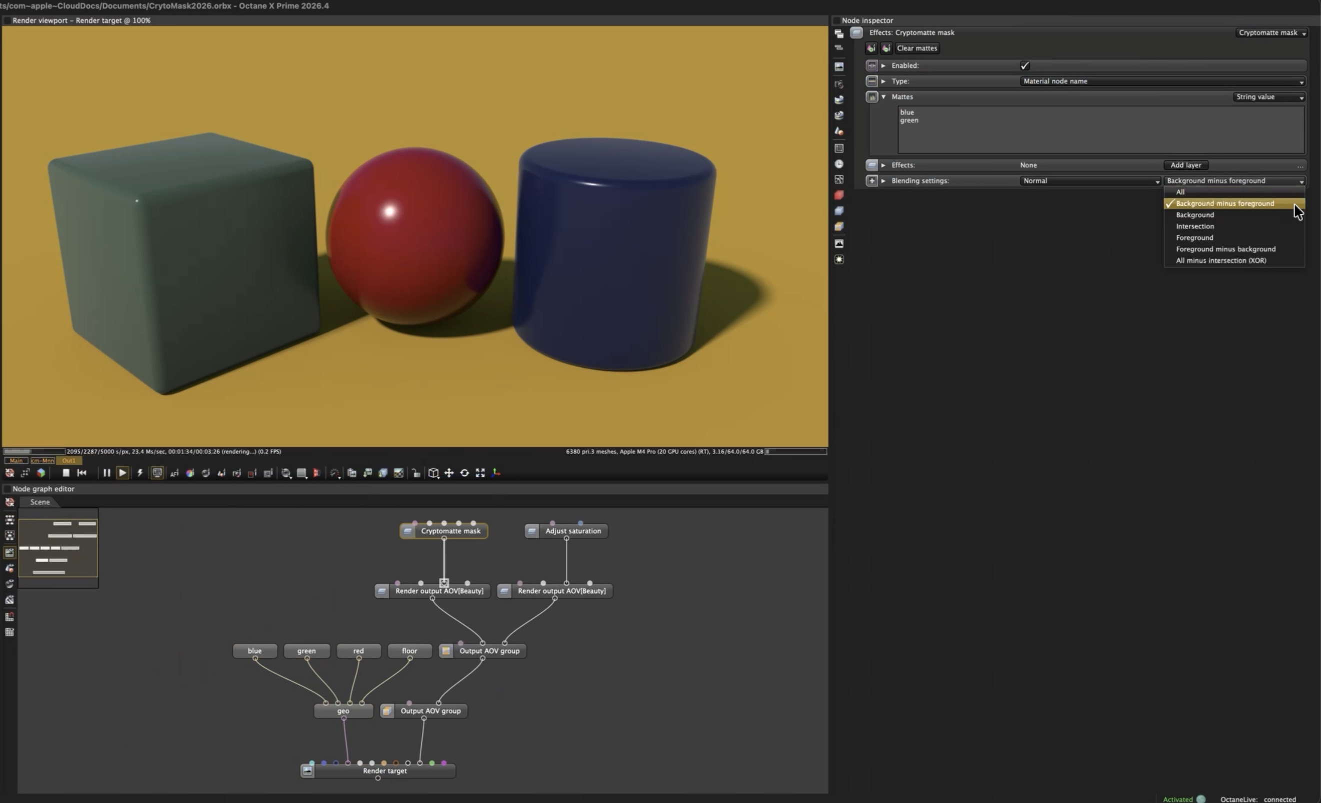

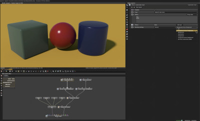

About Cryptomatte mask, please have a look at the following possible solution.
CrytoMask2026.zip
(154.67 KiB) Downloaded 30 times

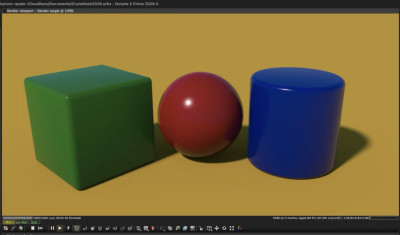

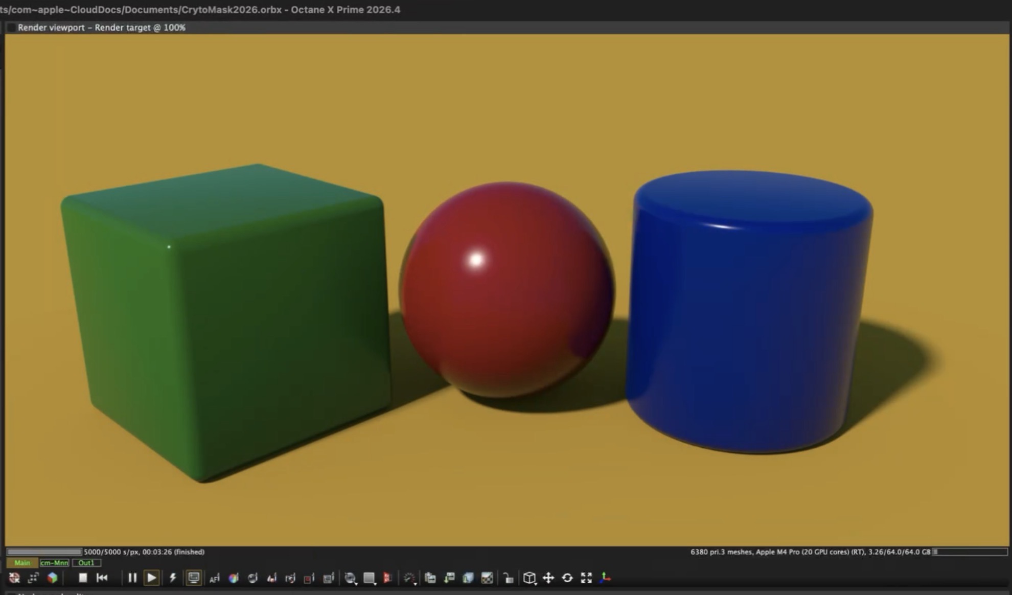

Let's say that we want to desaturate only the green cube and the blue cylinder.
In the first Layer there is the desaturated beauty AOV, while in the second layer there is the masked beauty aov, with Cryptomatte mask sets to material-node-name:
The trick is to change the Regions in Blending settings to "Background minus foreground".
