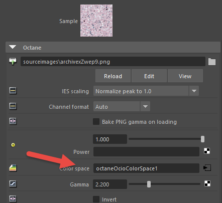

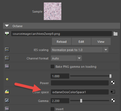

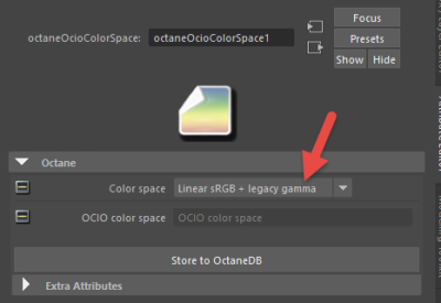

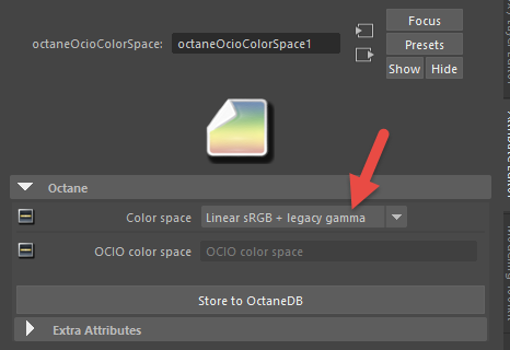

To make use of legacy gamma you need to set up the texture appropriately. Something like that:

JimStar
Posts: 3850
As I said - all works OK on my side. After setting the OCIO like on the pictures, when I modify gamma value it affects the render result.
