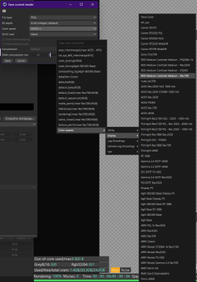

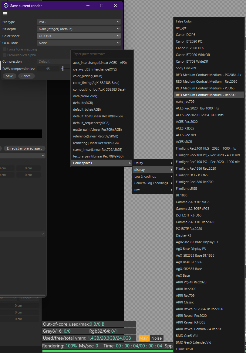

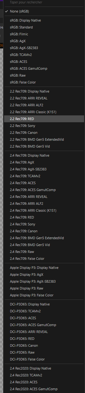

Hello ! I'm running into a problem and it seems like no one as experienced this before as I found nothing about it, basically my OCIO names are broken when it come to saving, for exemple if I want to use the "2.2 Rec 709: RED" profile, when it comes to saving, i'm getting a windows with completely different profiles, and I have to try and guess which one is the correct (which usually takes a few tries sadly).
Is there something I done wrong somewhere ? I'll attach screenshots of the two version of the dropdown menu to give more context !

"Save file as" profile selector
LV profile selector
LV profile selector

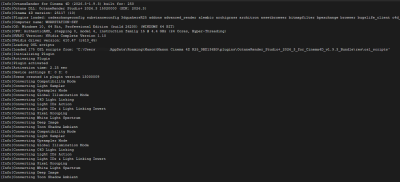

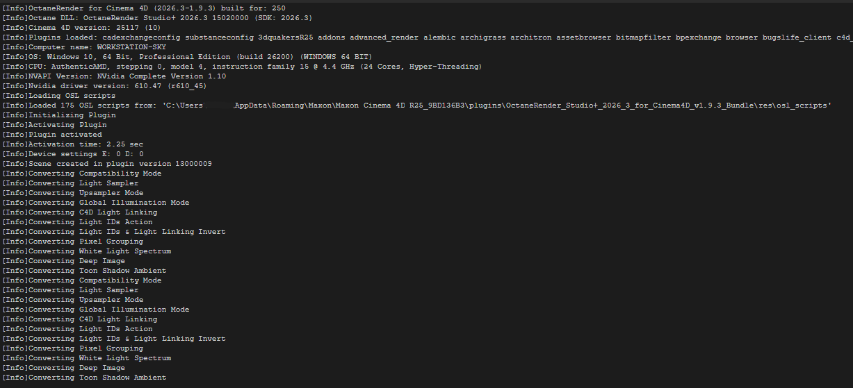

Please go to c4d menu Extensions/Console/, (Shift+F10), then select "OctaneRender" on the left, and share a complete screenshot of the panel, or copy paste the OctaneRender console output in your answer, thanks.

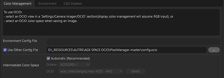

Which exact config.ocio file have you loaded?

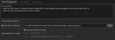

Please also share a screenshot from Octane Color management panel.

I'm using "PixelManager-master" OCIO config file, they come from here : https://github.com/Joegenco/PixelManager
Attached the two requested screenshots. Let me know if you need anything else !
