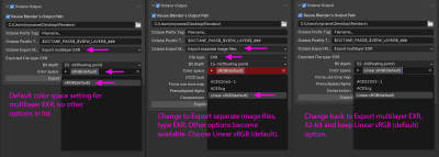

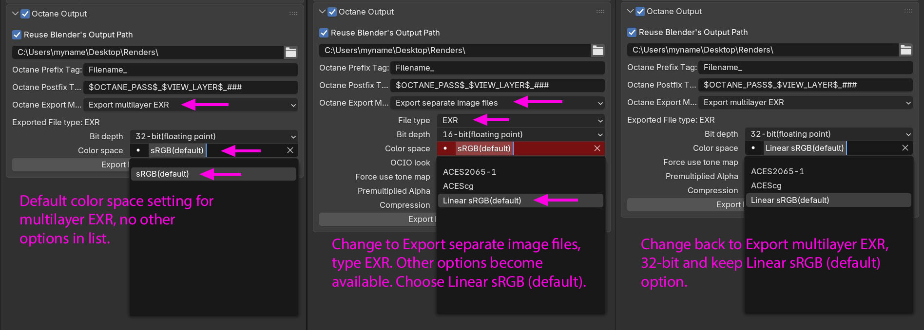

Ok, call me stupid for taking so long to figure this out, but it seems the 'correct' way to save a Multi-layer EXR from Blender Octane is to use the Octane Output filepath and options to automatically save your render on completion. This gives me correct color management and cryptomatte into Photoshop.
However, there's a weird behaviour. When choosing the multilayer EXR export, the only available color space option is sRGB (default) which gives incorrect color in Photoshop. If I change to Export separate image files and EXR, I get more color space options and sRGB (default) is removed (highlights in red as not available). Then if I go back to multilayer EXR it keeps the other options. Linear sRGB (default) gives the correct color into Photoshop.
Just documenting it here in case anyone else is having the same problems I had.
- linograndiotoy
- Posts: 1529
- Joined: Thu Feb 01, 2018 7:10 pm
Yeah, I also noticed there's some kind of UI "glitch".
We'll look into that.
Thanks!
Thanks!
