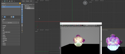

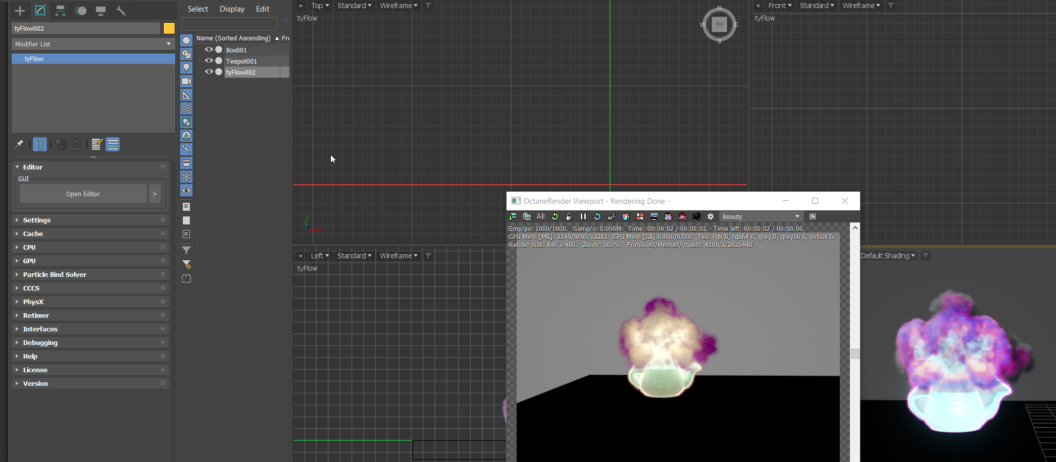

Basic usage steps:
New scene
Set Octane as renderer
Create a teapot
Create a tyFlow object
Open Editor (tyFlow)
Add a Birth Inferno
Select Interno Emitter
Pick button : select the teapot
Close tyFlow editor
Move the timeline to frame 100 (to let tyFlow do the simulation now)
go to frame 50
Open Octane viewport
Check that the render match approximately the display in the 3dsMax viewport.
Close Octane viewport
Select the tyFlow object
Add a OctVolumeTyFlow modifier.
Open Material Editor
drag the medium from the modifier to the Material editor (Instance)
The render should be the same as without modifier
Adjustments can now be made to improve the result.

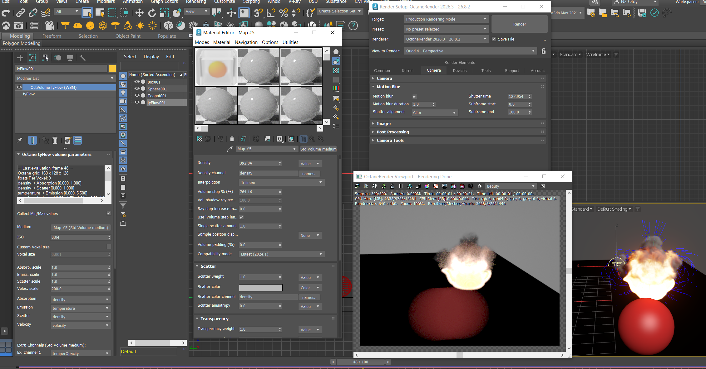

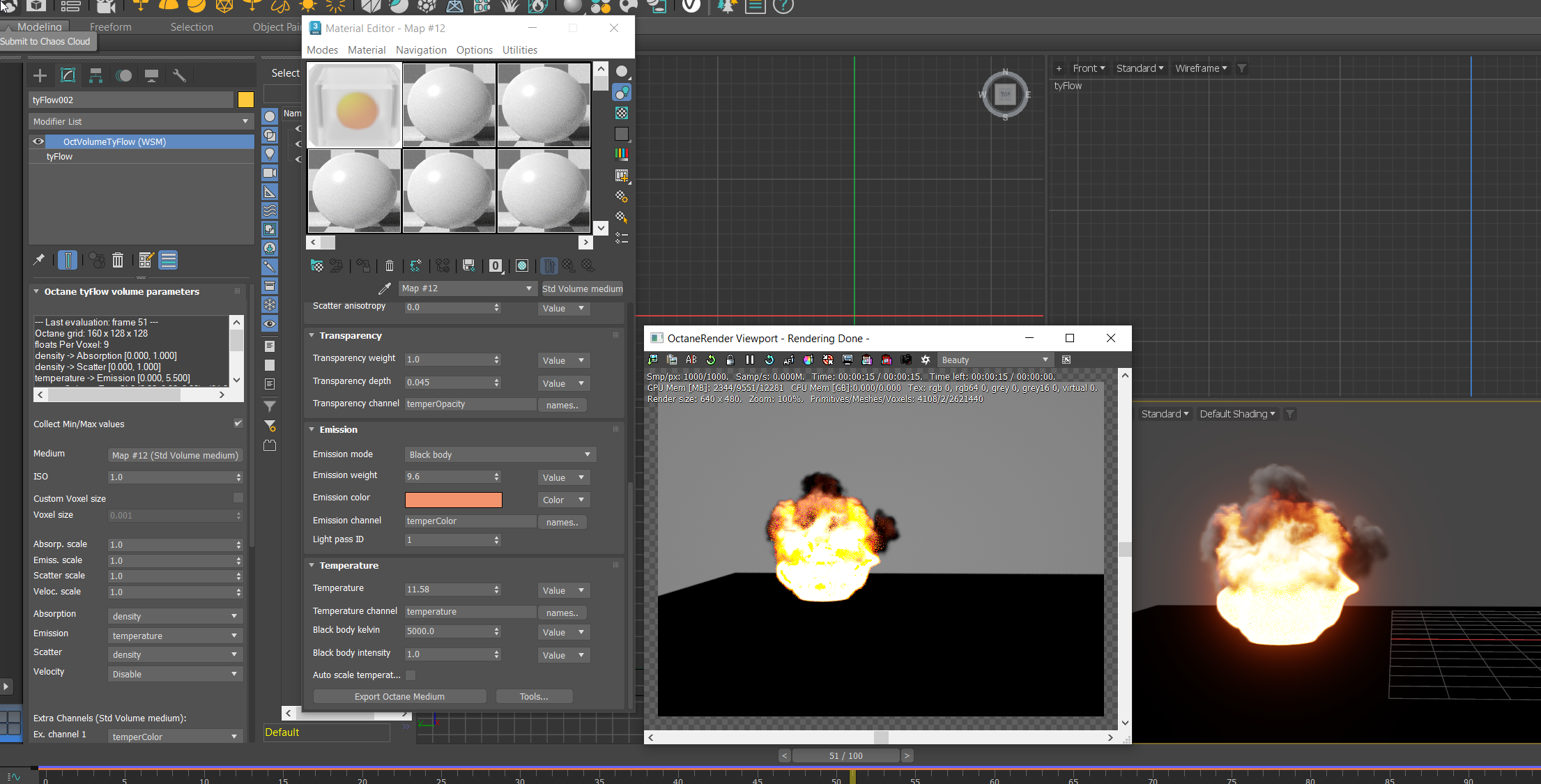

Channel remapping
The first step is to read the values generated by tyFlow.
In the OctVolumeTyFlow modifier, enable 'Collect Min/Max values'
Then, open the Octane viewport to start rendering.
That will display the min and max values of each channel for the current frame in the modifier text box.
For example,
density -> Absorption [0.000, 1.000] shows that the tyFlow 'density' channel is assigned to the Octane 'Absorption' channel, and the values and in the range [0,1].
This channel do not need to be remapped.
temperature -> Emission [0.000, 5.500] shows that the tyFlow 'temperature' channel is assigned to the Octane 'Emission' channel, and the values and in the range [0, 5.5].
This channel should be remapped.
temperColor -> ExtraCh1 (0.00, 0.00, 0.00) - (15.00, 14.55, 14.78)
Use the 'Channel remapping' section and select one channel to edit.
Enable 'Remap channel'
Set Old Min and Old Max to the tyFlow values (eg Old Min:0, Old Max:15.00) and
Set New Min and New Max to the desired Octane values (eg New Min:0, New Max:1.00)
Once the remap is set, the 'Collect Min/Max values' can be disabled for better performance.

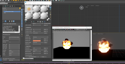

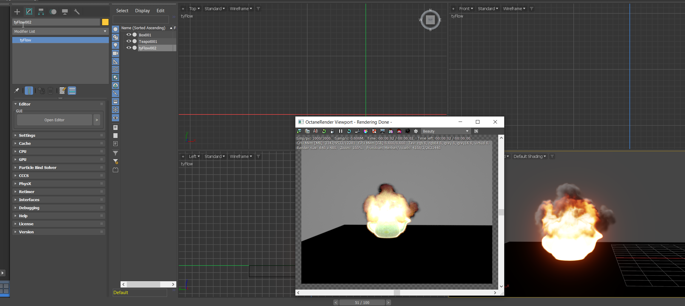

Inferno_Fire_classic_01_noModifier.max

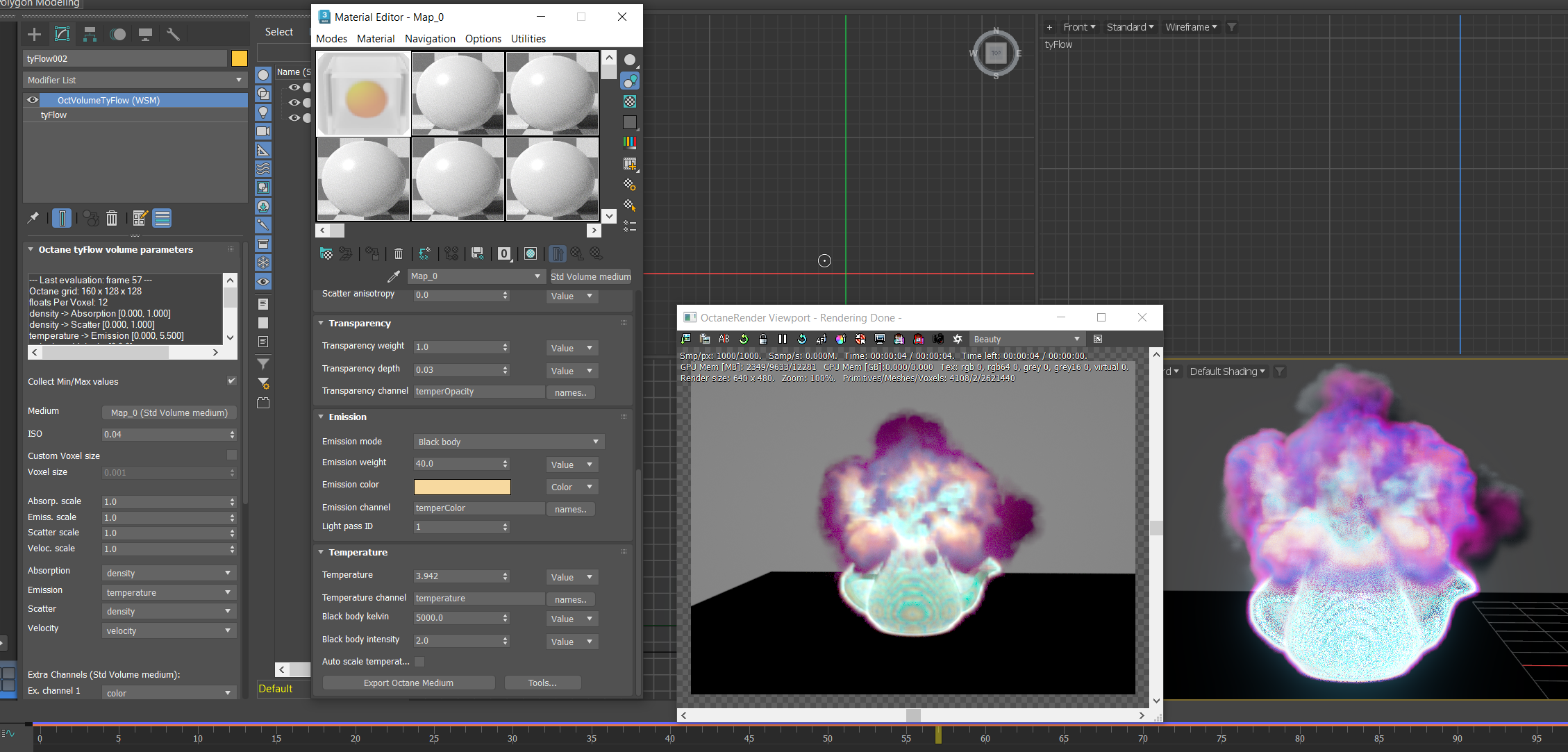

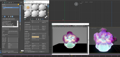

This is a simple fire created with tyFlow default settings, and no Octane setting or modifier.

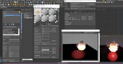

Inferno_Fire_classic_02.max
Same as previous sample, but with the Octane OctVolumeTyFlow modifier.
The channels 'temperature' and 'temperColor' have been remapped to the [0,1] range
In the Std Volume medium (Map #12), the Emission color has been set to a light orange, that is multiplied with the temperColor channel

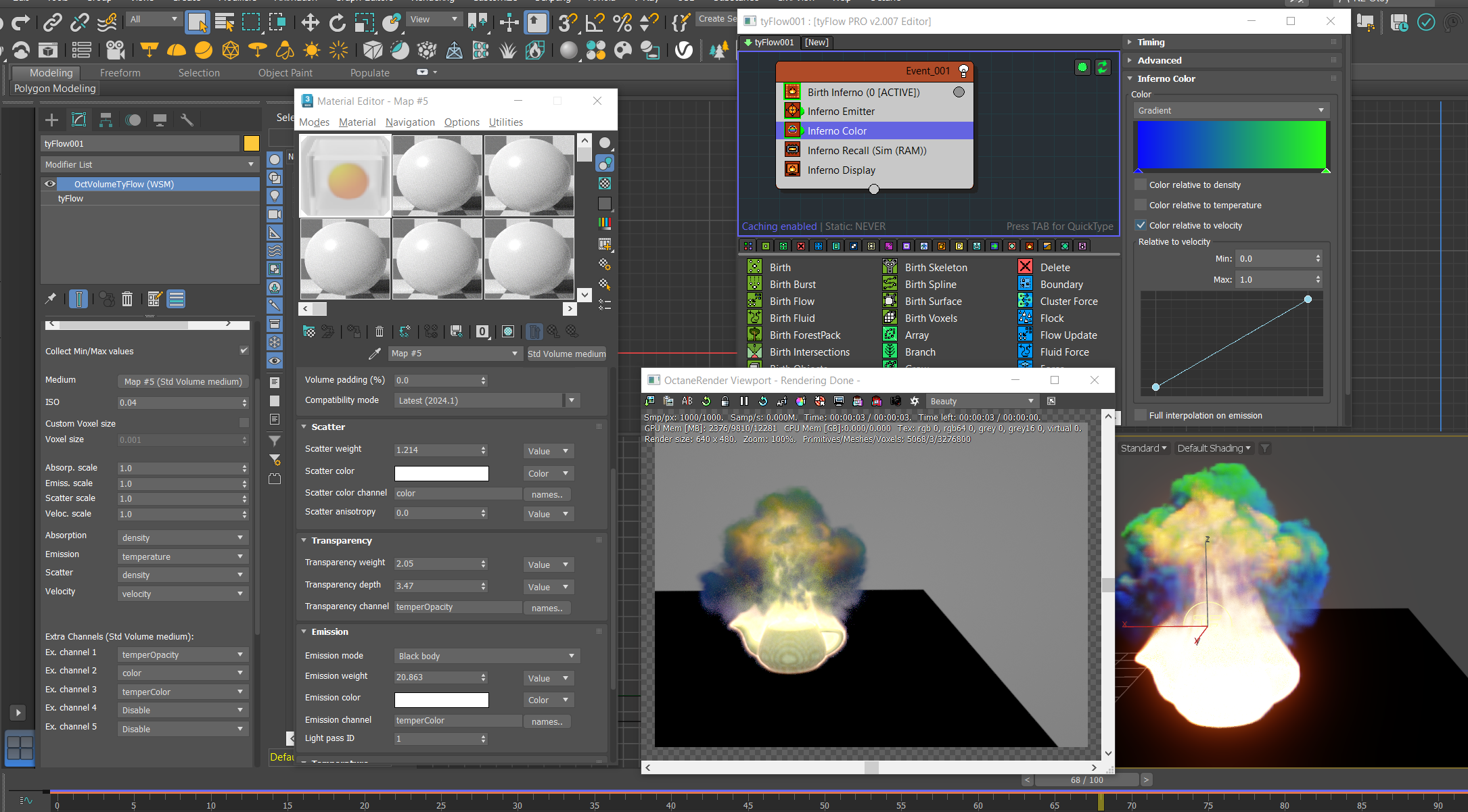

Inferno_Fire_CoolMagic_01_noModifier.max
This illustrate the tyFlow Fire color in the Inferno Display operator. The preset 'Cool Magic' has been selected.
Inferno_Fire_CoolMagic_02.max
The modifier and the medium have been adjusted to match the tyFlow viewport display.

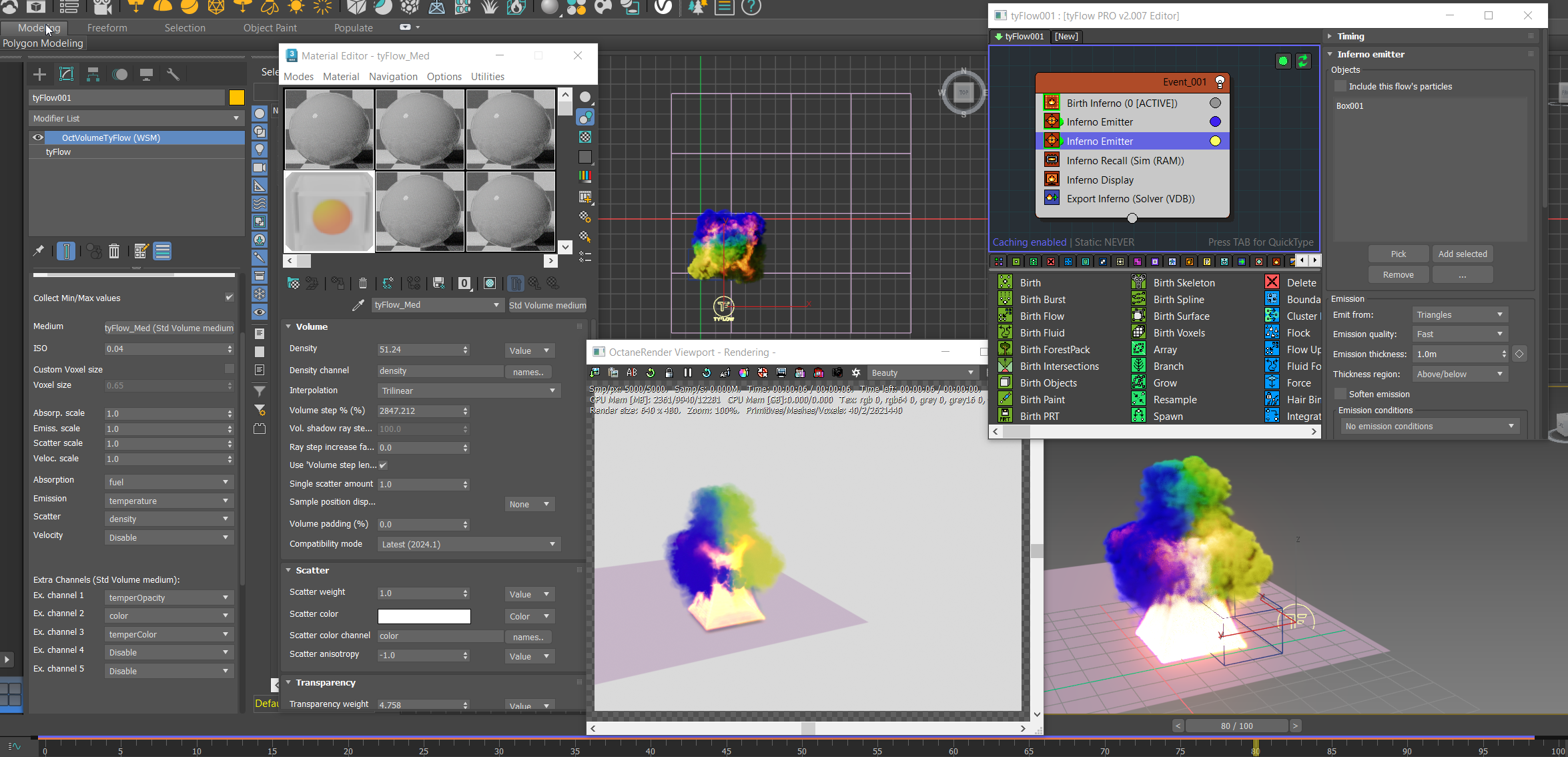

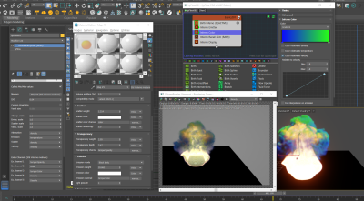

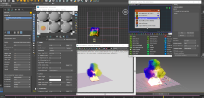

Inferno_MultiColors_01.max
The first Inferno Emitter operator was setup with a color emission set to blue.
A second Inferno Emitter operator was added, with a color emission set to yellow.
Those colors are accessible to Octane via the 'color' channel, and is set in the Scatter color channel of the Std Volume medium
Inferno_MultiColors_02.max
An Inferno Color operator was added, and uses a color gradient from blue to green.

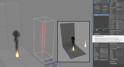

inferno_velocity01.max
This uses the velocity with a scale of 200
The Octane object property for tyFlow001 has Object motion blur enabled, and the Render settings/Camera has Motion Blur enabled.
Adjust the shutter time to see the effect of the motion blur.

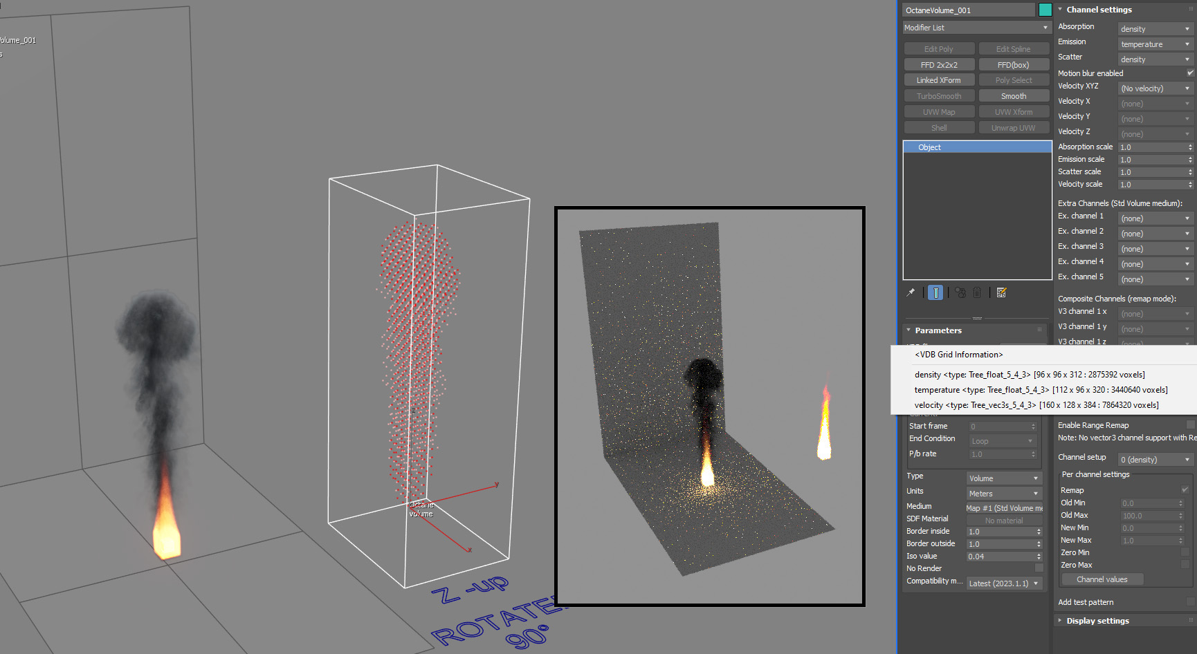

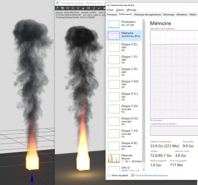

I have some question because I'm a noob with vdbs : I tried to use medium created by OctVolumeTyFlow modifier to a vdb exported from my Tyflow inferno simulation, and I'm not able to see Density , just temperature...
Any idea ?

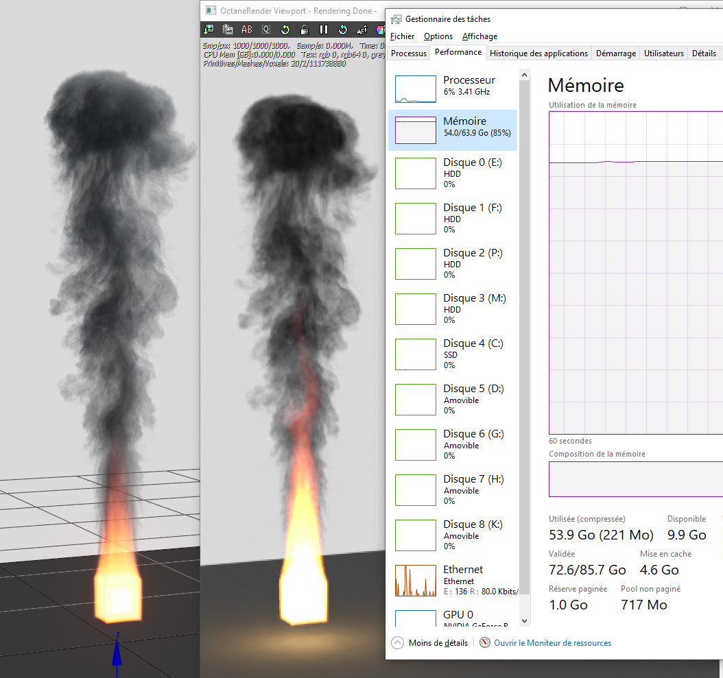

I tried a very detailled Tyflow Inferno ( I mean very low Voxel size in Tyflow ) : Memory size exploded :lol: ( need a good balance between voxel size in tyflow sim and voxel size in Octane )
Could it be possible to have a command menu to hard kill octane viewport, because sometimes it is impossible and I need to hard kill max... :twisted:
Best regards.

Hi HHbomb,
Thank you ! Glad to hear that the inferno usage is straightforward !
The default medium created for the OctVolumeTyFlow uses the special channels temperColor and temperOpacity
but those 2 channels are not available in the exported VDBs..
So you need to replace temperOpacity by density in the Transparency section, and the temperColor by density for example, in the Emission section.
The 'color' channel should work and could be used to display the fire color I think, but you'll need to setup the Inferno nodes for that..
If you need a typical flame / fire, you could use a Volume medium instead of the Std. Volume medium, and setup the colors with a volume ramp. That would work for inferno and VDBs
Here is a sample with both an tyFlow Inferno object and the corresponding exported animated VDBs in an Octane volume object:
Inferno_Fire_classic_11_VDBs.zip
(10.99 MiB) Downloaded 33 times
The killing of the octane viewport is not easily possible unfortunately.. but one of the reason it can be stuck in calculation is a too low Volume step..
While experimenting, make sure it's in the 50~200+ % area.. and set your sample per pixel to very low, like 50 spp..
For the memory usage, big grid takes big memory.. see if you can disable the tyFlow cache, this might help..
