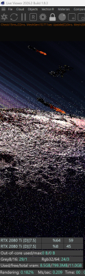

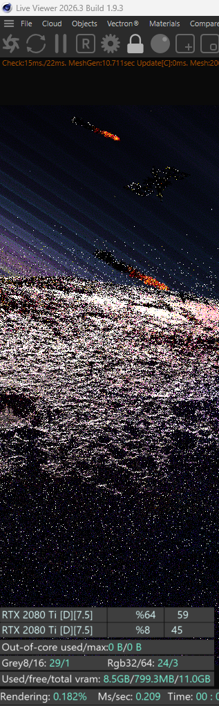

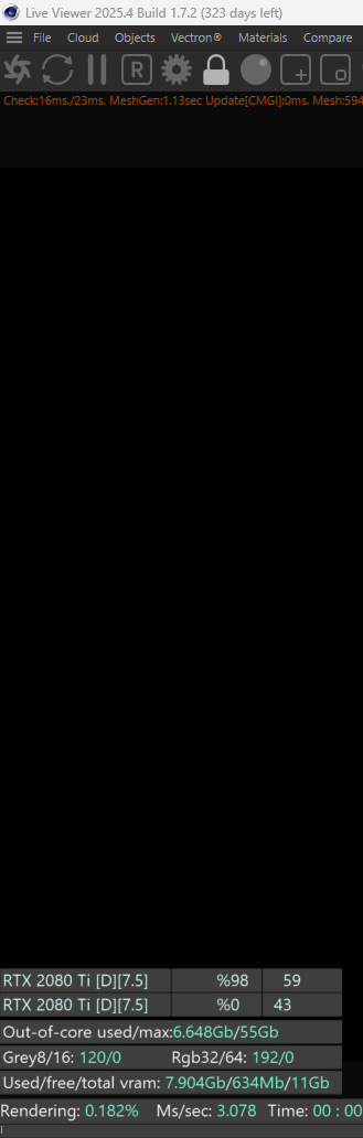

So quick Summary im rocking some slightly dated hardware still Dual RTX 2080Ti's but hey still capable so my question were we left behind in support in 2025? did i miss something cause no verison of 2026 that i have downloaded goes out-of-core when rendering in the live viewport i have tried opening some pertty dense scene's and either it will crash trying to render the viewport getting standard errors like that i ran of memory but i got 128gb of ram to play with so i can go out of core a little but i seems no version of 2026 uses my out fof core please any help on this would be lovely also i have another topic on here that is waiting on answer.

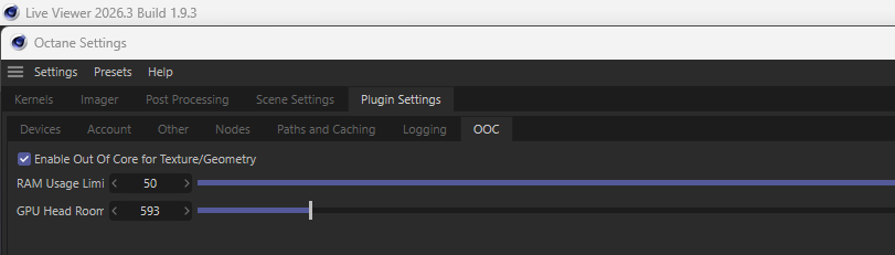

Out-of-core works as expected here in 2026.x, could you share more info?
Please share a screenshot of Out-of-core settings, then please go to c4d menu Extensions/Console/, (Shift+F10), then select "OctaneRender" on the left, and copy paste the OctaneRender console output in your answer, thanks.

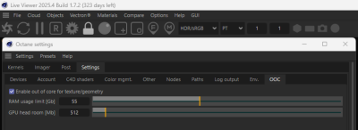

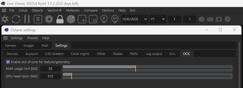

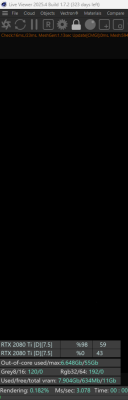

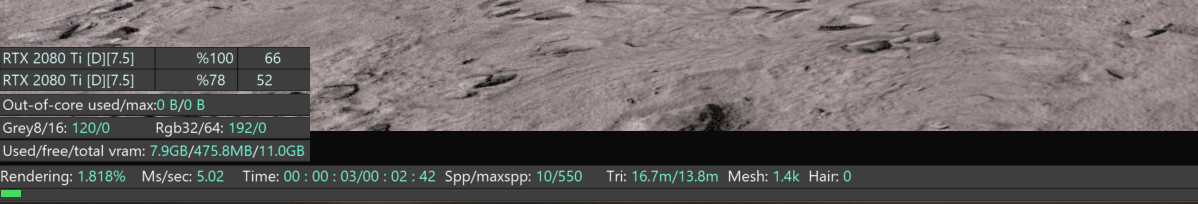

Hello Sorry for the delayed response here are my settings between the versions of octane i have been using 2025.4 and back seems to have Out-of-core Working properly but anything 2026 and beyond seems to not show any numbers when rendering and i do believe this is an issue cause i have had large scenes not render in on 2026 but will on 2025
