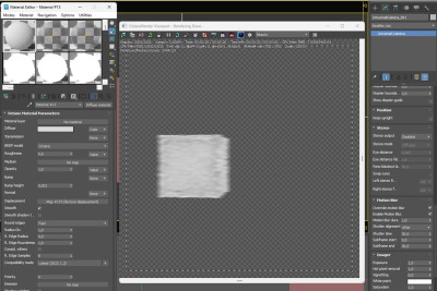

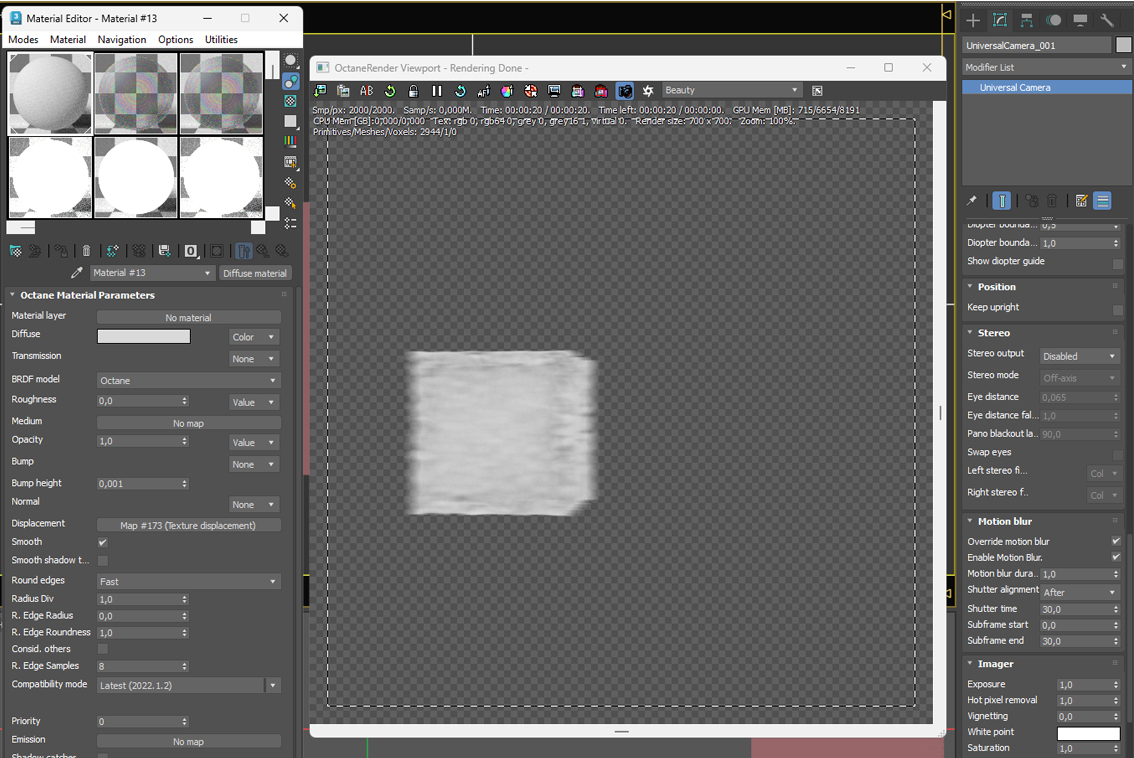

Motion blur doesn't work with displacement, please see attached video and override motion blur in cameras is broken again :
Enregistrement de l'écran 2026-06-03 193615.mp4
(16.38 MiB) Downloaded 8 times

remKa wrote: Wed Jun 03, 2026 5:36 pm Hello,
Hi remKa,
I’m unable to reproduce the issue on my end, it seems to work fine here. Could you share an example scene that reproduces it?

Hi remKa,
I also couldn't reproduce the issue.
Check with the attached scene, maybe use a png instead of a tif for the displacement texture ?.. If you can send us a sample, we'll have a look.
MB_with_displacement05_mx24.zip
(538.21 KiB) Downloaded 1 time
For the override motion blur, in fact it works. The issue comes from the default values for Shutter time and Subframe end, that are incorrectly set to 0.5 and 1.0 when creating a new camera. Change those to around 100.0, and it should work. Those incorrect default values will be fixed in the next release.

Hello,
No luck with a .png neither, please find my scene here : https://www.swisstransfer.com/d/db876f86-3fad-4b04-9fbc-a019f699f85e
