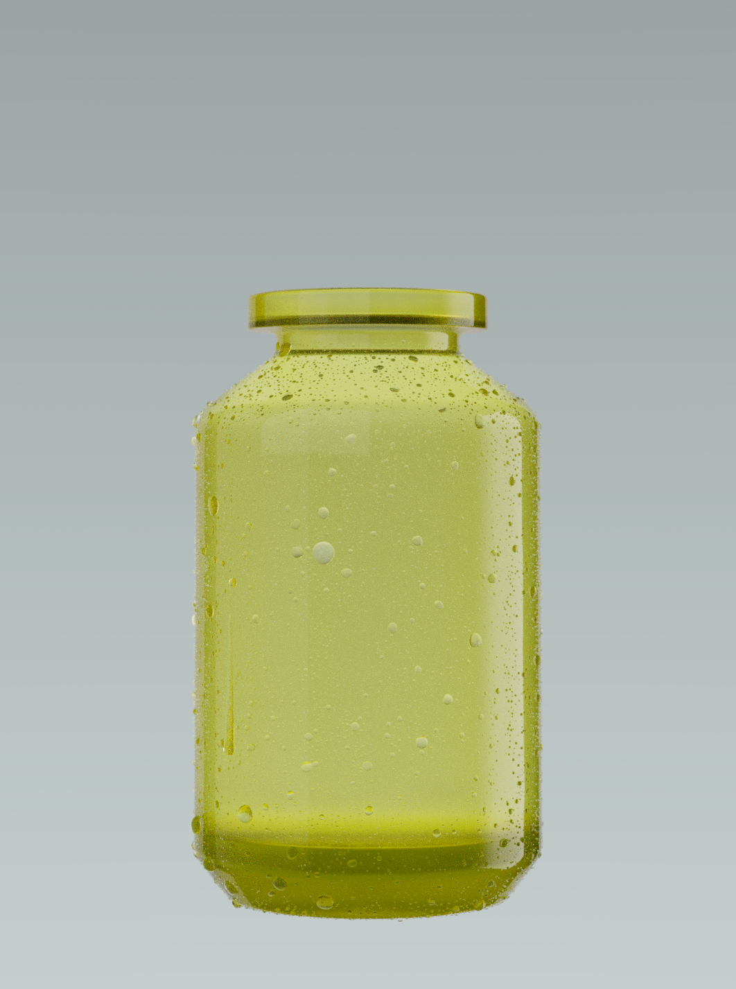

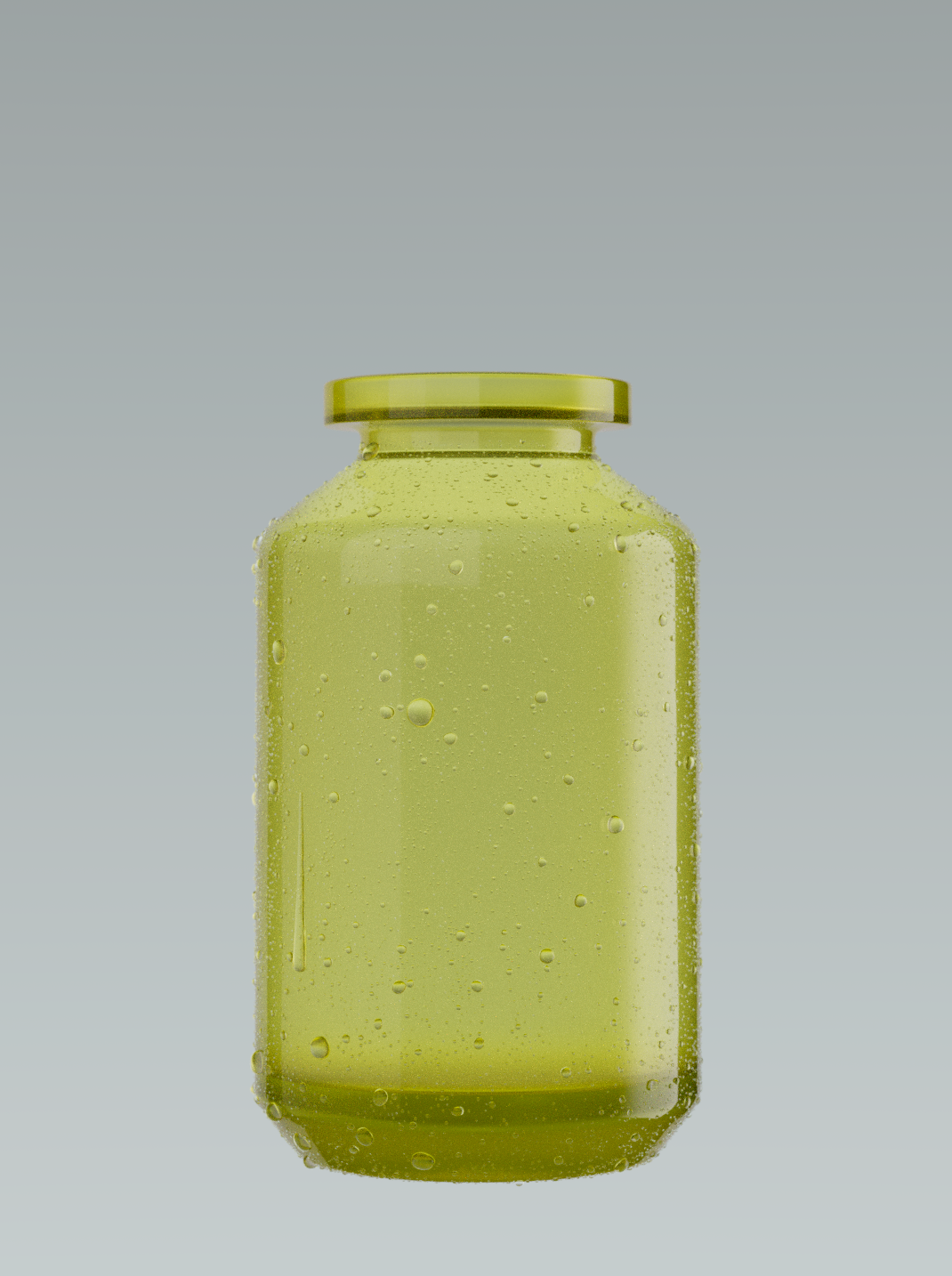

Somehow when i use Nested Dielectrics the condensation droplets get too bright.
The top image shows with nested ON. the bottom with OFF. The droplets have a higher priority.
I don't think this is the desired behaviour, is it?

One thing that's required with nested dialectics is that they overlap. Do the droplets overlap with the glass?
And have your tried inverting the priority (making the droplets lower)?
