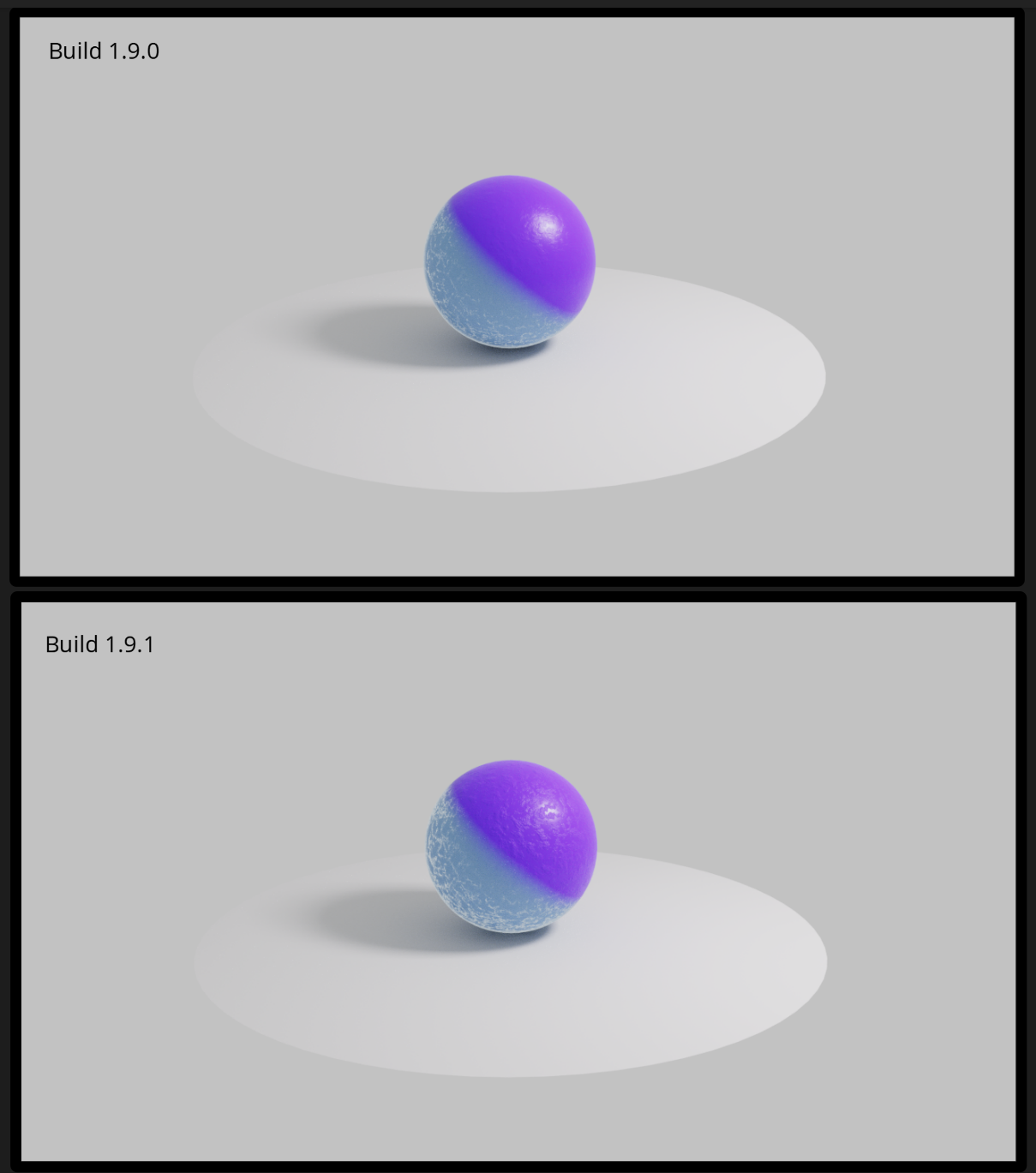

One more thing I noticed when rendering an existing scene from 1.9.0 in 1.9.1: Some node heavy materials change their look a bit. I think it might be connected to usage of the Gradient Node and you do list this node under the "improved color conversion" section. Could this be possible, even for just a grayscale gradient? I will try to make some tests with a simpler material.
Yes. For 2026 color conversion for these nodes was basically always wrong unless using legacy srgb or the value was exactly 1 or 0.
However we did add scene conversion that should keep scenes the same
Could you send me a scene with some of those materials (before they were converted to 1.9.1)

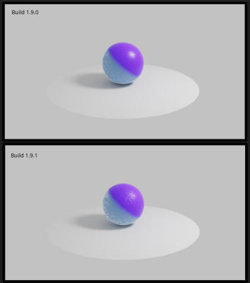

Tim0042 wrote: Thu May 21, 2026 7:34 am One more thing I noticed when rendering an existing scene from 1.9.0 in 1.9.1: Some node heavy materials change their look a bit. I think it might be connected to usage of the Gradient Node and you do list this node under the "improved color conversion" section. Could this be possible, even for just a grayscale gradient? I will try to make some tests with a simpler material.
Brought the material into a basic scene and simplified it a little bit. Purple submaterial has a noise node going into a gradient going into the bump, blue submat has a fresnel masked via a noise, also filtered through a gradient.
The same scene in 1.9.1 seems to result in a brighter fresnel and a clipped or otherwise adjusted bump noise. Still not sure if it does have something to do with the gradient, but I attached the c4d. =/
//EDIT: Ah, just saw your response after I was done typing - yep, I hope this helps and thanks for looking into it! : )
//EDIT: Updated the image, as I forgot to re-apply ACES in the LV for the new plugin version, so now the comparison is clearer - sorry!

Tim0042 wrote: Thu May 21, 2026 9:04 am
Thanks for the report. Apparently the gradient node was not being version converted to the new version of the plugin resulting in different values.
I added a fix. It will be part of the upcomming hotfix. I suspect tomorrow.
