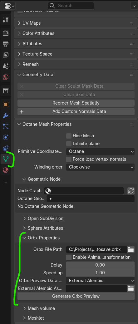

You can import an ORBX file using the Orbx Properties:

dinosgr
Posts: 69
Joined: Mon Jul 28, 2025 1:48 pm
Have a default cube on your scene, if you start with the new octane render startup you have it.
then go to object properties and select your orbx scene, start the render.
dunno about anything else as i haven't use it so much.
Best
Konstantinos

Hi Konstantinos,
thanks much!
Dont know what I did wrong before, but now it works!
Except the "Generate Orbx Preview" like you said.
Get that same error.
regards
Mike
linograndiotoy
Posts: 1553
Yes, the generate ORBX preview option is not supported yet in this version.
