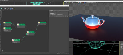

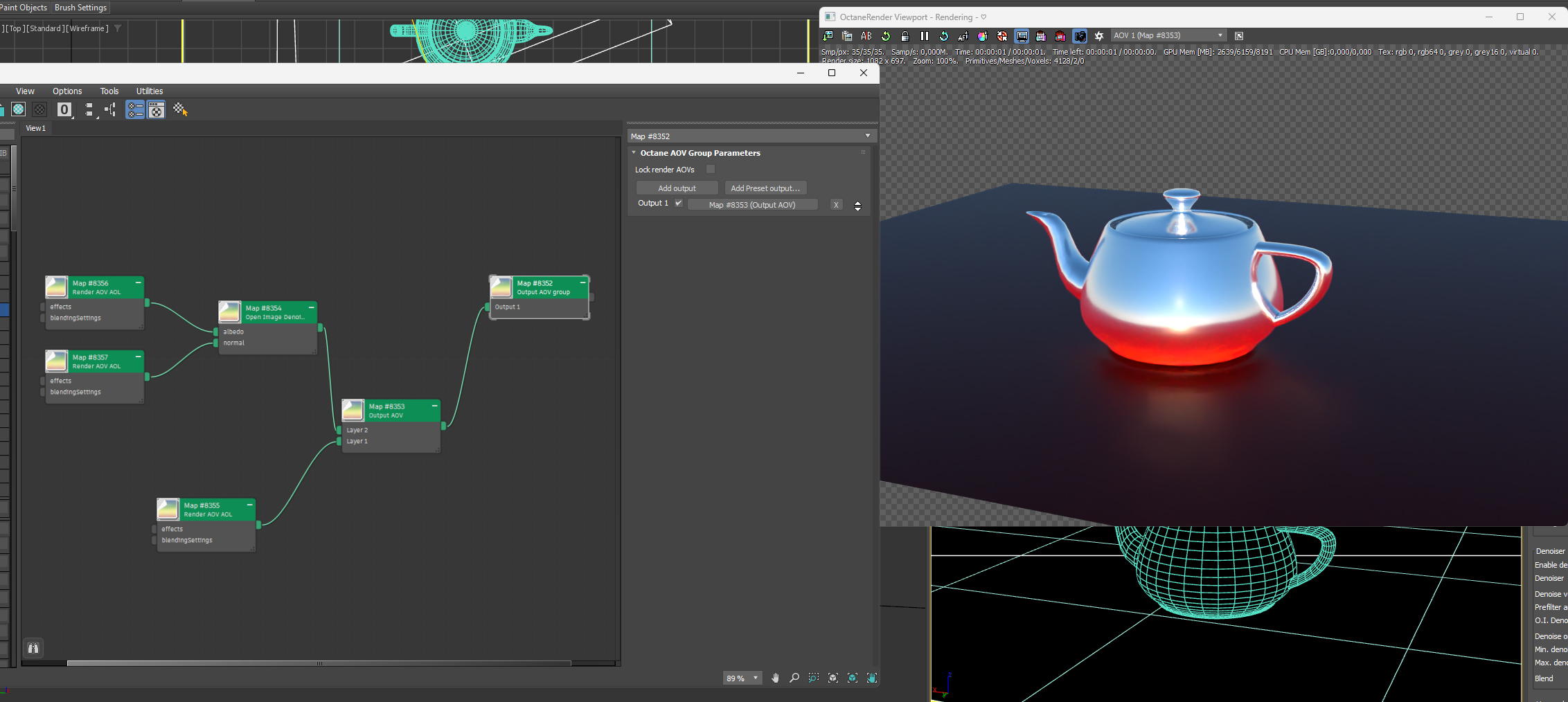

Hi remKa,
I was able to reproduce the issue with the compare tool. I’ve attached the denoise workflow. Still investigating the camera.
Regards
Paride
Regards
Paride

Hello Paride,
Thank you for the compare issue.
I find it way too complicated to use AOV to et a denoised reflection pass, couldn't we have the same possibility than with the Octane denoiser ?

Hi remKa.
I don’t think that’s doable, Open Image Denoise is an external Intel framework. It’s solid and fast, but it has some limitations also on single layers compared to Octane’s spectral denoiser. Anyway, the AOV system might seem a bit tricky at first, but it can become fast and really useful for quickly creating custom layer groups.
Regards
Paride
