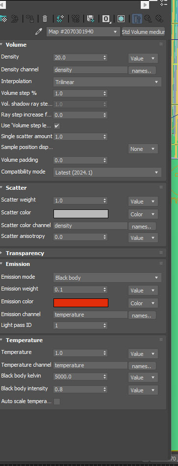

Starting with the 2025 versions, there is a problem with VDB files. The parameters, viewport and timeline have started lagging.

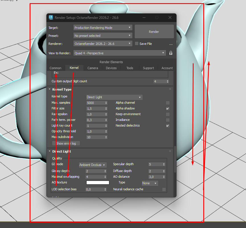

If the GPU memory consumption shoots up (or crash) when the feature is enabled , please try to lower the max tile sample count.Elvissuperstar007 wrote: Tue Mar 17, 2026 6:37 pm I think I found the reason why 3D Max crashes without a reason, I turned it off Neural radiance cache.
It was enough to turn it off, and for now 3ds Max doesn’t crash. Looks like the issue is specifically in that feature.
No, it’s still crashing, but not as often as it did with that feature enabled.

It crashes even without this function, so it's most likely not related to it. I described the core issue below — it seems something is wrong specifically with Octane. Other plugins in 3ds Max work stable, and Octane 2024 runs fine as well. However, versions 2025 and 2026 crash when enabling or disabling the Octane dynamic viewport.

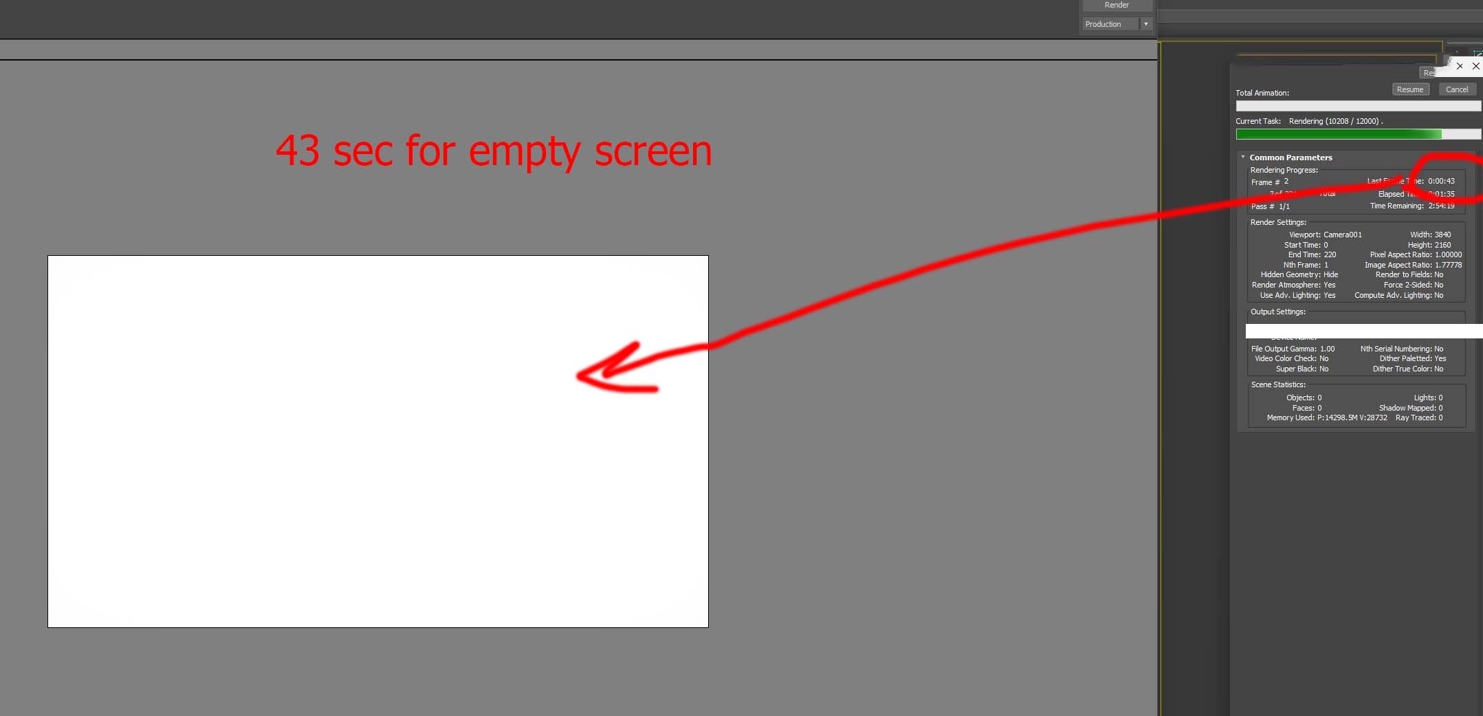

Why does OctaneRender spend 43 seconds per frame rendering an empty screen before the mesh even appears in the camera view? (A simple mesh is in the scene but hasn’t yet entered the camera frame.) This issue has been happening for years. Rendering an empty screen takes a lot of time. Since the introduction of parallel samples and other VRAM-consuming features like AI light and the denoiser, your software has become too bloated. We lost a lot of VRAM for denoiser and AI light, so in the end we didn’t gain much—just the same speed.

Hi coilbook,coilbook wrote: Tue Mar 24, 2026 2:17 am Why does OctaneRender spend 43 seconds per frame rendering an empty screen before the mesh even appears in the camera view? (A simple mesh is in the scene but hasn’t yet entered the camera frame.) This issue has been happening for years. Rendering an empty screen takes a lot of time. Since the introduction of parallel samples and other VRAM-consuming features like AI light and the denoiser, your software has become too bloated. We lost a lot of VRAM for denoiser and AI light, so in the end we didn’t gain much—just the same speed.
Try these changes and compare the results. Switch from the Octane AI Denoiser to Open Image Denoise, which in my tests turned out to be significantly lighter in terms of per-frame overhead. Also make sure that Denoise on Completion is turned on, because with it off the denoiser runs intermediate passes during sampling that can add a lot of unnecessary time. If you're not relying on AI Light for the scene, try disabling it as well, it reserves VRAM and adds its own per-frame recalculation cost that on simpler frames might not be worth it. Finally, try raising the Adaptive Sampling Noise Threshold, with Open Image Denoise handling the cleanup at the end, you might be able to push it higher than usual without visible quality loss. Start from something like 0.05 or 0.06 and go up from there. The engine will stop sampling earlier and the denoiser takes care of the residual noise. This combination could cut your frame times quite a bit, especially on simpler frames. Worth testing on your specific scene to see how far you can push the threshold before the quality starts to drop.
