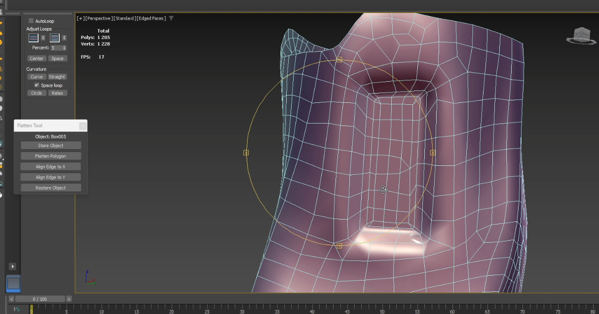

Thanks again for your plugin, here is my script, feel free to use it
2026-03-06 17-43-41.mp4
(51.86 MiB) Downloaded 46 times
Flatten Polygon Tool.rar
(1.35 KiB) Downloaded 36 times

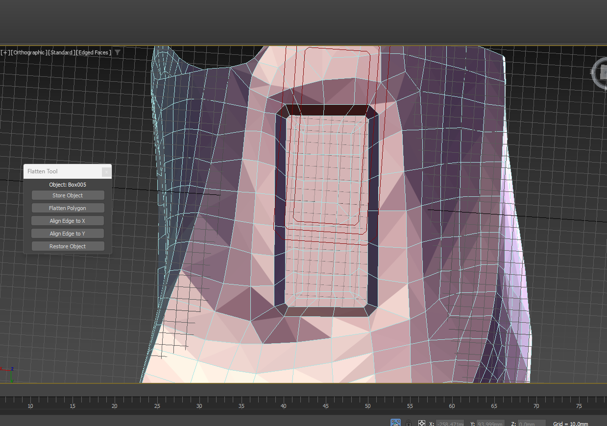

Elvissuperstar007
Posts: 2603
Location: Ukraine
More
SelectBoundaryEdges.rar
(6.27 KiB) Downloaded 32 times
Coplanar Selector.rar
(5.99 KiB) Downloaded 40 times
ScreenRecorderProject2.mp4
(45.26 MiB) Downloaded 38 times
Elvissuperstar007
Posts: 2603
Location: Ukraine
Later I will add a function to load the coordinate history in case the coordinates were saved but the objects were not restored to their original position.

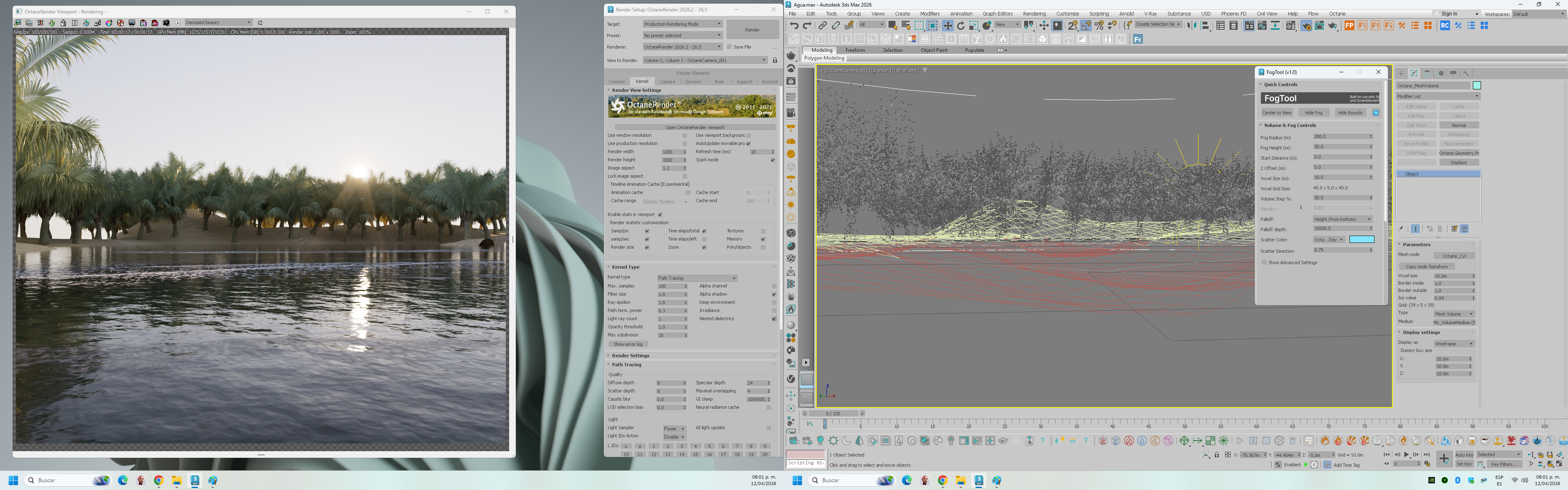

Excellent script for creating fog.
I can't get the fog to appear like in your video.
In the test file you uploaded, the fog is visible, but I follow the steps and values, and I don't get the same results. In fact, there's no fog at all.
Thanks for reading this email.
I've attached a test image.
No appear fog
No appear fog
Agua.rar
No fog
(904.09 KiB) Downloaded 35 times
Windows 11 Pro for Workstations x64, Ryzen 5950x, 128 Gb ddr4 Bus 3600 mghz, Noctua NH-D15, M2 1 Tb SSD WD Black SN850X NVMe 7300 mbps, 8 SSD HP S650 1 TB, 1 RTX A4000, power source Corsair 850 w Platinum Series, mb X570 wifi plus Asus
Elvissuperstar007
Posts: 2603
Location: Ukraine
On tropical islands, classic “northern” fog typically doesn’t occur. Instead, you more often get a light rainy haze due to high humidity. Clouds also tend to cling to mountains and can linger there for long periods.
The dense fog created by this plugin is more typical of northern latitudes — it forms under the influence of cold air and wind.
Pelana001_1
Posts: 34
Joined: Wed Sep 18, 2024 10:46 pm
Location: Mérida, Yucatán
Hi Elvissuperstar007, I believe the FogTool plugin or script is designed to create that volume light effect.
I don't know much about these types of plugins, but I think you could achieve the same result using FogTool in any environment.
Thank you for your comment, very kind of you.
