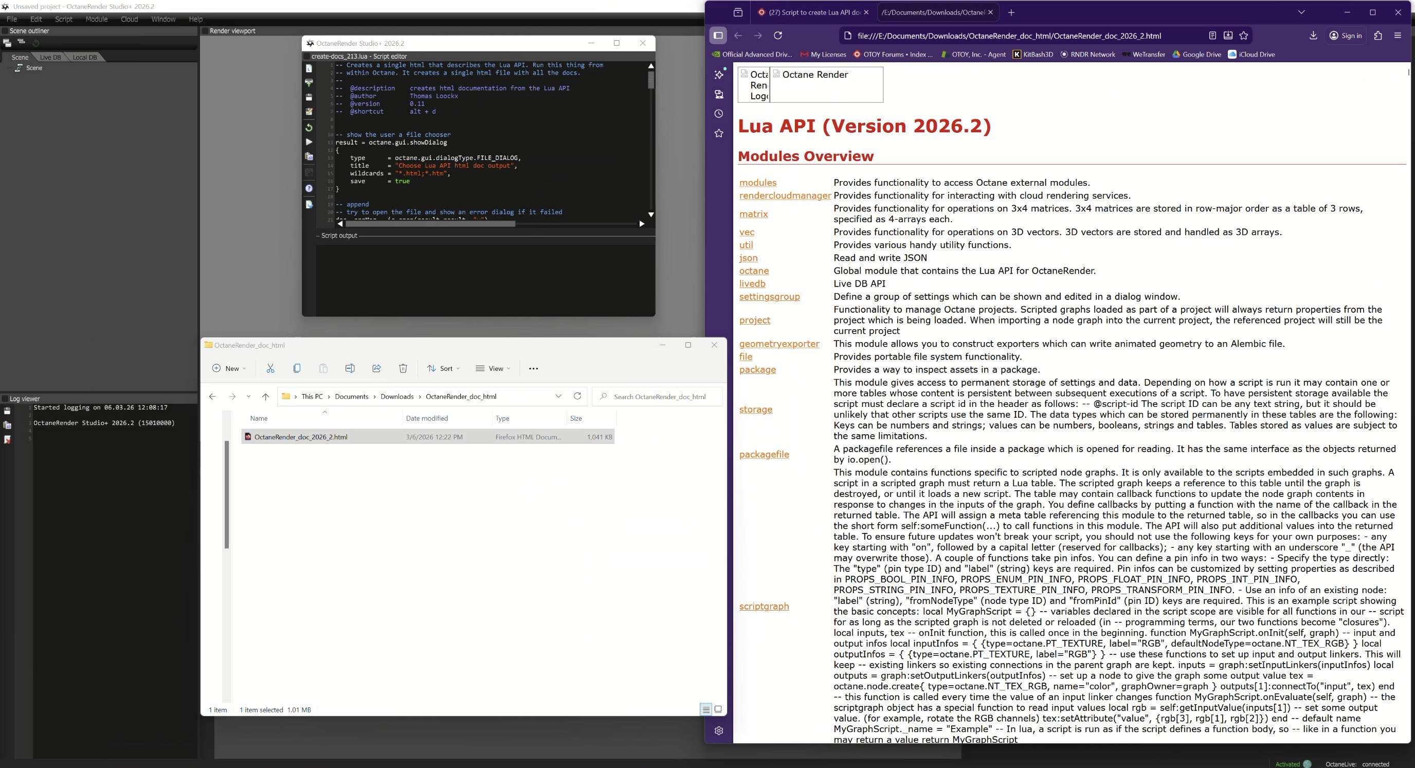

And about LUA API, if you run the script in the first page of this discussion in OctaneRender Standalone 2026.2 you get this:
OctaneRender_doc_2026_2.zip
(129.11 KiB) Downloaded 69 times

Here's a definitely vibecoded version of this that works with latest octane builds, and exports a full HTML searchable copy with tons of info along with a robot friendly json file.
Octane_Lua_API_Complete_Exporter.lua
(30.86 KiB) Downloaded 27 times
