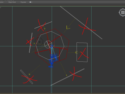

Hi coilbook,
It should be something like this, more or less, and then it can be adjusted as needed.
Regards
Paride

coilbook
Posts: 3176
paride4331 wrote: Thu Feb 26, 2026 4:36 pm Hi coilbook,
Regards
Paride
01ge.zip
Thank you!
Anyway to get better vram usage. Parallels samples from 16 to 32 use like 2 gb of vram, AI light uses like 3-4 gb of vram. That's a lot of wasted vram. So half of 12 GB of precious vram gets used by octane for technical purposes only.

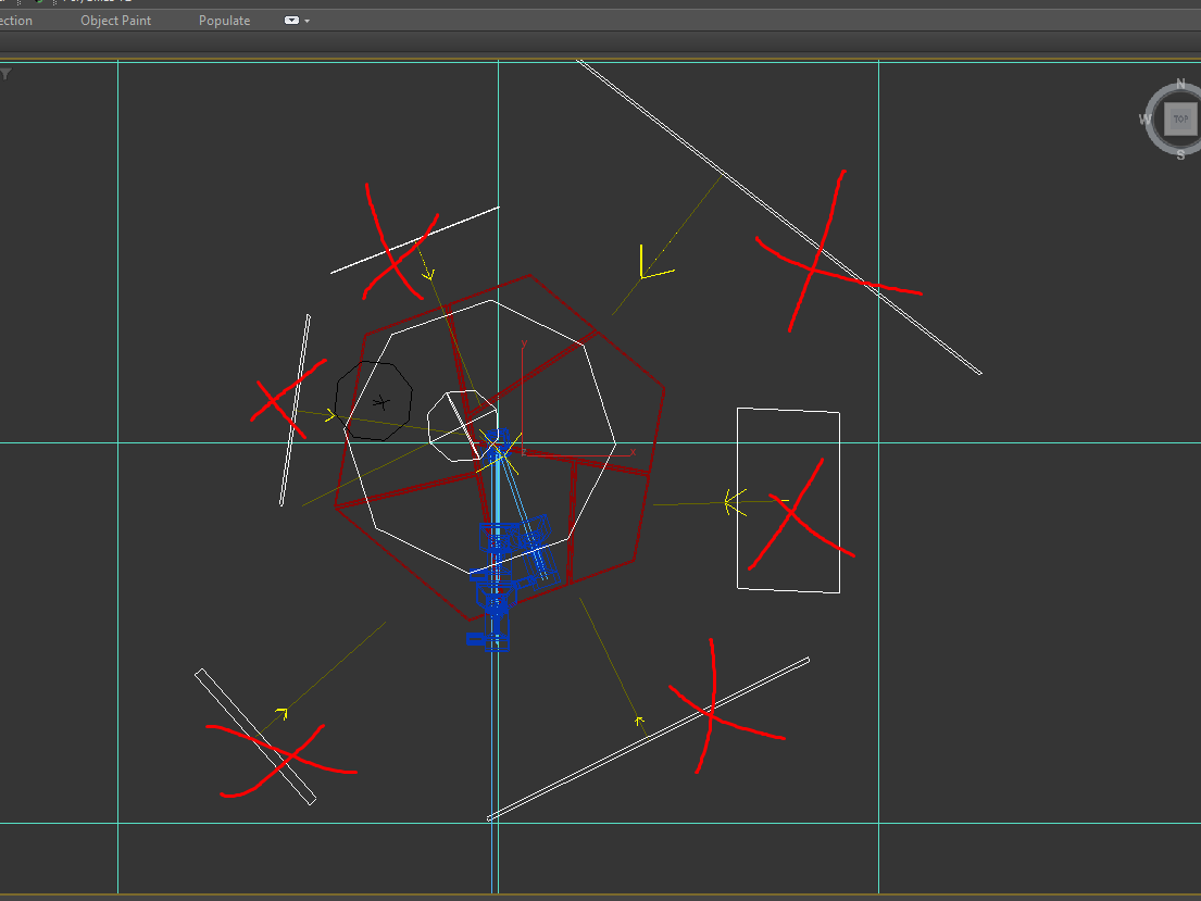

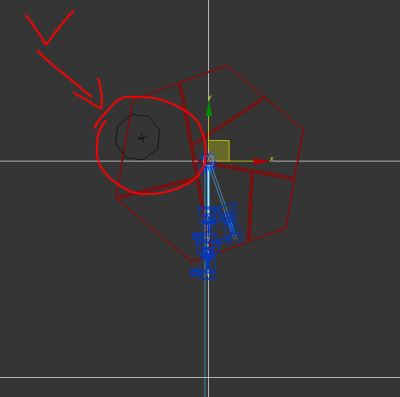

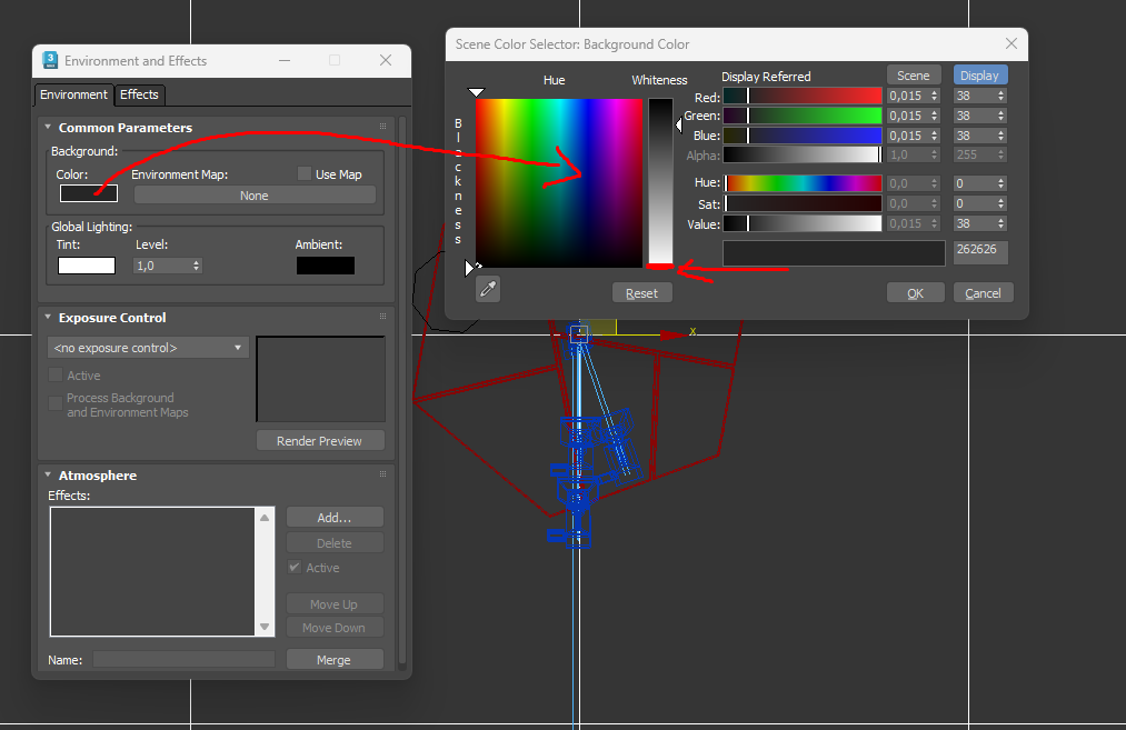

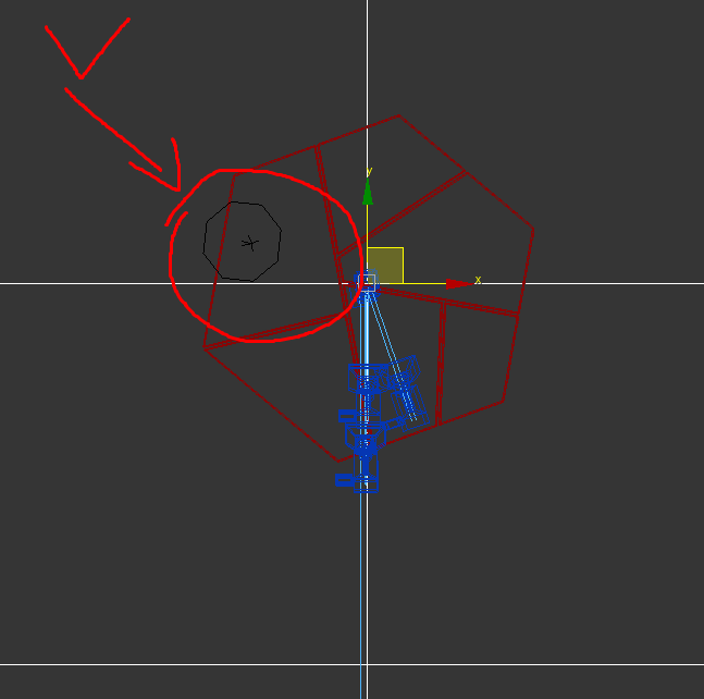

Try rendering for about 10 minutes while changing materials on the model in real time. All materials are present in the Material Editor.
Close the Octane Interactive viewport.
Hide the group of light sources and enable one light that is currently turned off.
Go to the 3ds Max Environment settings and change the light color from gray to pure white.
Try to start the interactive viewport again — 3ds Max will close without any error message.
This happens every time. At the same time, 3ds Max does not crash if I render while changing materials. However, as soon as I change the environment, disable the main light, or enable a previously disabled one, it crashes immediately — but only when launching the Octane interactive viewport. If I restart 3ds Max and adjust these parameters before rendering, everything works fine and it renders normally.

Hi Elvissuperstar007,
I can’t reproduce the issue on my side. Maybe I’m missing something, or there’s a specific step I’m not taking. Could you clarify the exact sequence of actions?
