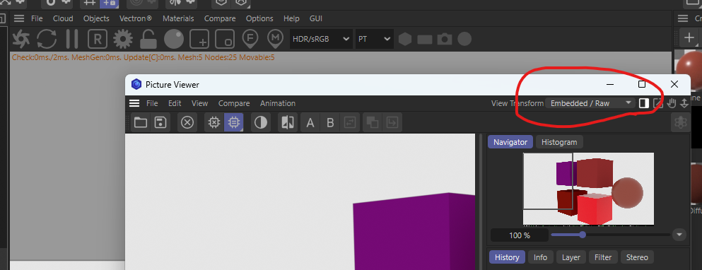

I assume you are looking at the picture viewer? We are currently working on a solution for that.
In the meantime you can set the view transform to raw. That will show you the results in the selected colorspace in the OctaneRender PV Render Settings.
Ofcourse going to the legacy color space still works aswel.

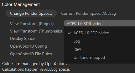

Yea color management is a bit tricky in C4D. Lets go over the expected behavior from top to bottom with the default OCIO settings in 2026
The Render Space at the top is the internal colorspace that C4D uses to store color information and do its calculations.
In C4D2026 this defaults to ACEScg, and previously in linear sRGB. Octane stores its colors as Linear sRGB and does its calculations using spectral rendering.
The Display Space is the colorspace the render results will be stored in. sRGB by default in C4D 2026. However you also will not see this colorspace by default.
Which leads us to the most important colorspace, the View Transform (Project). This is what the C4D viewport will be displayed in. It defaults to ACES 1.0 SDR-video.
This is what you actualy see in C4D at default.
When set to Raw, you will see the "Render Space", which will be ACEScg. <- This should match Octane LV when set to ACEScg
When set to Un-tone-mapped, you will see the "Display Space", which will be sRGB. <- This should match Octane LV when set to sRGB
When set to ACES 1.0 SDR-video it will be that colorspace. To make Octane LV match you need to load the same OCIO file as C4D and select it in the settings and LV
Now that being said. You will still see differences in colors between Octane and C4D. This is because lighting intensity and material light response will differ between Octane and C4D, and you will need to get them right.
Thank you so much! Everything is much clearer now.
