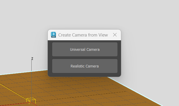

I did create a macro script a while back that lets you create a Universal camera or a Realistic camera from the current active 3ds Max viewport view. I would always use the create camera from view in 3dsmax for Vray Cams or Physical cameras but no option for doing that with Octane cameras

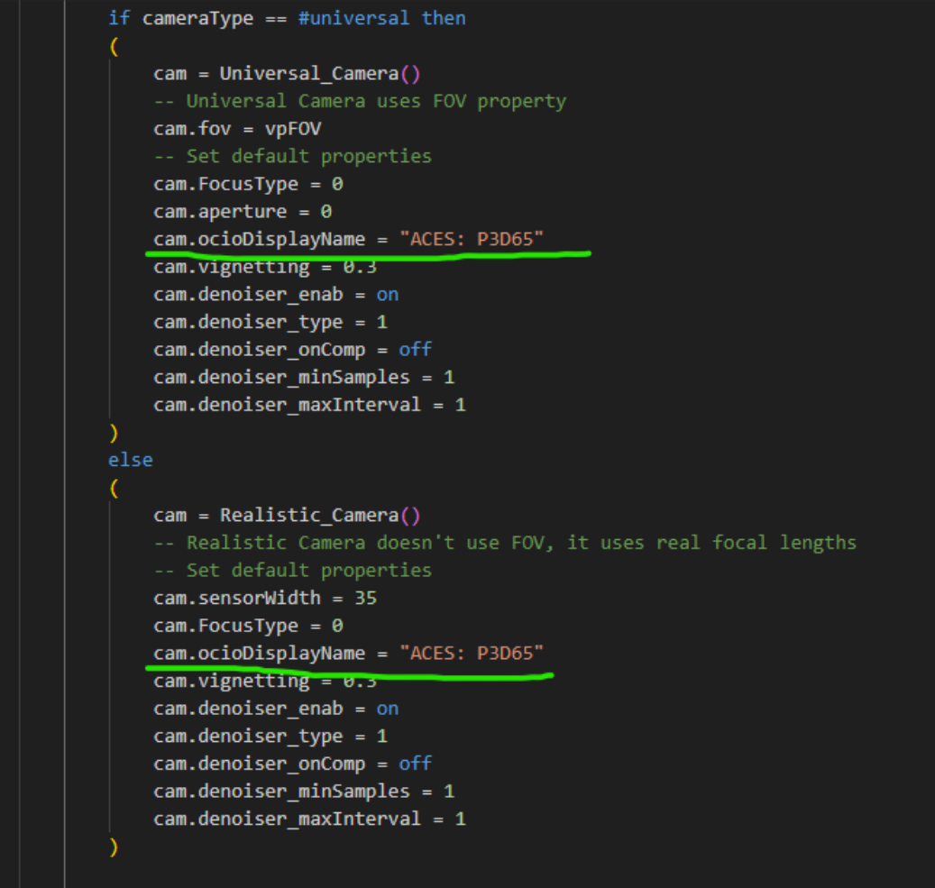

You can configure some of the defaults in the script. I suggest either updating or removing the ocioDisplayName to your display view or remove if you do not use one
Install
- Just drag the macro into Max,
- Restart max
- Customise toolbar > Quads/Toolbars > Category 'Byrom' > Create Octane Camera from view
works with latest version of Octane Plugin 26.5

In my script
cam.FocusType = 0
This is the 'Focal Depth' focus type, and you need to change the focal depth in meters or use the focus picker in the render view to get the correct focus.
If you want autofocus for example, then change the script so the values are
cam.FocusType = 1
For the Realistic Camera, they have a fixed aperature meaning you will always get depth of field, which could be perceived as out of focus if your focal type/depth is not set correctly
However, for the Universal Camera I set
cam.aperature = 0
Which disables DOF completely for the Universal One and will speed up the render.
