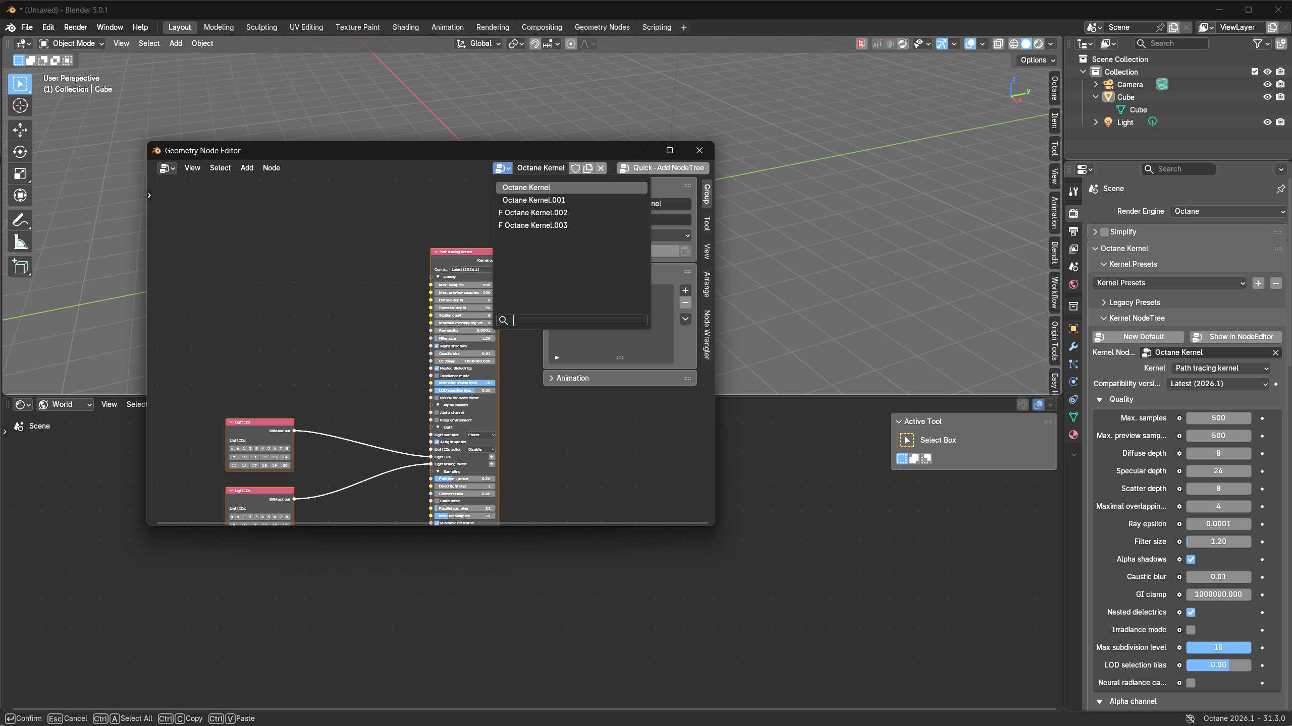

As the title say, deleted the kernel and saving scene with no fake user or with fake, kernels never deleted, no rush I am just reporting what I see.After Purge Data all kernels are there

I even removed everything, installed the 31.3 addon.
Kernels don't delete, in editor.
Add 3 or more kernels and in editor select the one you want to delete, press shift-X the kernel is still on list.I mean with the little x icon that exist for any element in the editor.
Can you check?

Are you deactivating the Fake User option before deleting the Kernel?

I know what fake user does, but working on save only.
you delete them but look they are still there.
when you click to select a new one to delete the previous file you deleted is there!
Simple to follow : add 3 kernels, delete one, open list again to select another, how many you have ? 3 ha?
delete all, how many you have? 3 ?
have a fake user in one kernel, save the file and recheck after loading, how many you have? 3?
Hope i am not confused from the hours checking lol
btw , this happens only with kernels, any world object , camera , material or any data works fine....

Oh, now I see what do you mean.
Let's see what we can do about. Meanwhile, you'll have to use purge! : :mrgreen:
