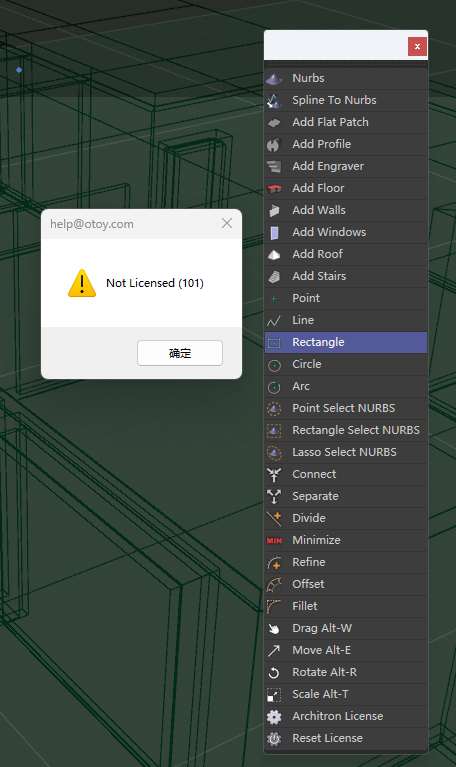

I am reaching out to get some help regarding a licensing issue with the Architron plugin for Cinema 4D.
The Problem: Everything was working perfectly until my workstation went offline. Immediately after the internet connection was lost, Architron stopped recognizing my license. It now displays a "No License" error or shows the license as invalid.

Update: I should have been more specific. I am currently online and my internet is stable, but Architron still won't recognize the bundled license. It seems like the "license seat" is locked or failed to trigger a re-check after the brief offline period. Does anyone know if there’s a specific cache file or a manual "Refresh License" button for Architron within C4D?

I apologize for this outage.
There were some problems with the OTOY license server, which should now be resolved.
If anyone is still having problems running an OTOY license with Architron or LWCAD, please let me know back.
Please report if this kind of error happens again via OTOY support or directly to me at lwcad.com support.
