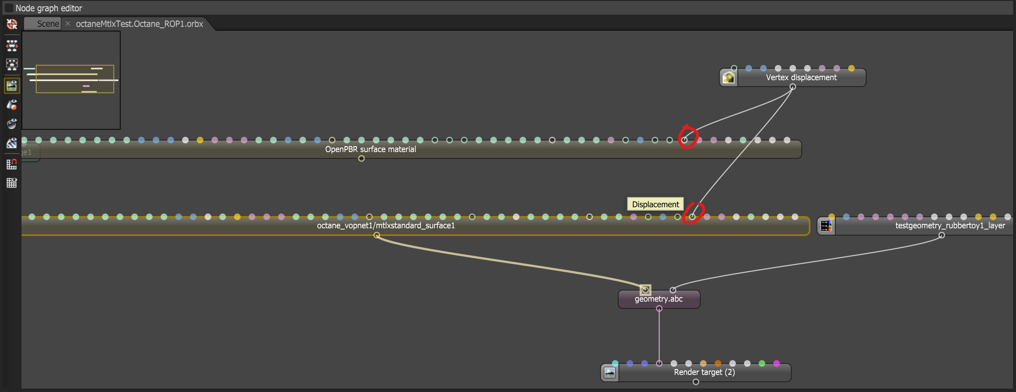

MtlX Standard Surface/OpenPBR Surface have a pin for displacement in Standalone but that is not the case in Houdini so there is no way to use displacement.
I've noticed it while testing Solaris but since this is also an issue in main plugin, might just report it here also.
viewtopic.php?p=442107#p442107
Win 10 64bit // GTX 4090 + GTX 3090 // 5900x // 64GB // SideFX Houdini // C4D

So the mtlx material in Houdini is just the native sidefx one so that doesn't have any of the octane specific features. For the octane features just use the native octane one. Under the hood the mtlx one gets converted to octane one anyway.
Now the openpbr octane one will be added in next release!
