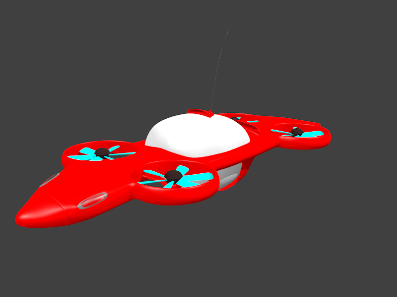

Output from Blender Render

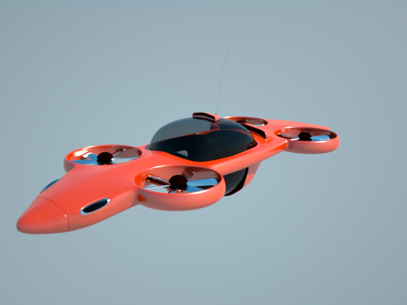

Render from Octane, strictly out of the exporter with no tweaking at all
