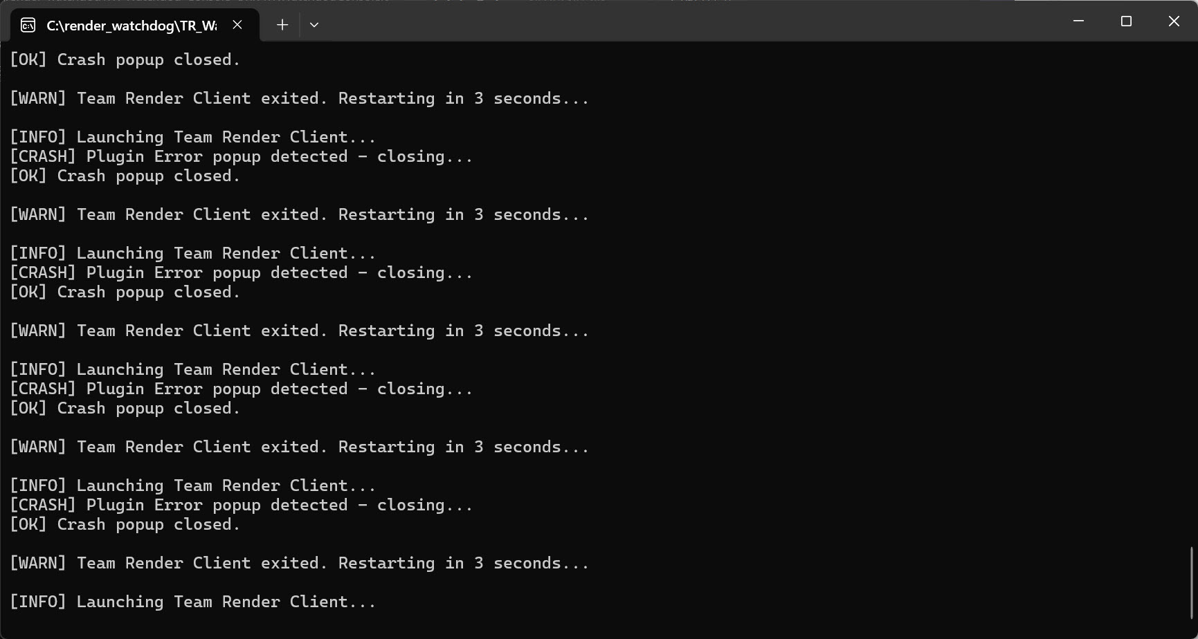

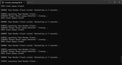

Updated version with timestamps of incidents
Here an examble of the LOG file
Code: Select all
[2025-12-10 07:44:13] === TR WATCHDOG (Console Only) ===
[2025-12-10 07:44:13] Monitoring Team Render Client + Crash Popups...
[2025-12-10 07:44:13] Press CTRL+C to stop.
[2025-12-10 07:44:13] [INFO] Launching Team Render Client...
[2025-12-10 12:29:40] === TR WATCHDOG (Console Only) ===
[2025-12-10 12:29:40] Monitoring Team Render Client + Crash Popups...
[2025-12-10 12:29:40] Press CTRL+C to stop.
[2025-12-10 12:29:40] [INFO] Launching Team Render Client...
[2025-12-10 12:50:50] [CRASH] Plugin Error popup detected — closing...
[2025-12-10 12:50:50] [OK] Crash popup closed.
[2025-12-10 12:50:50] [WARN] Team Render Client exited. Restarting in 3 seconds...
