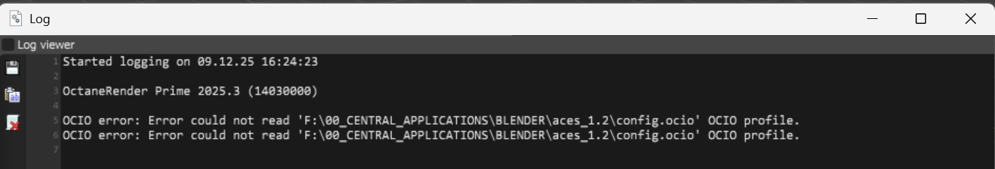

Ok, something new we've found for Octane Server. If you run out of memory, cannot load the Ocio, or something else goes wrong, Octane stops loading resources and will corrupt the credential file stored in …..user\AppData\Roaming\OctaneRender (see log file below). The render is starting to look weird, with some elements appearing black or without ACES applied, etc. The way to fix it is to log out of Octane Server, close it, restart it, and log in again, or replace the credential file with one you saved earlier in your “squirrel stash folder”, which also works.
This is definitely a bug, and Otoy needs to fix it.
To bypass the issue, we had to add a Python script to run first, kill the Octane Server, copy the new credentials, restart it, then the PowerShell script kicks in and performs the login. And all this has been controlled by Deadline before each frame. This way, there are no black frames, weird colour spaces, or any of the hundreds of things that can go wrong.
