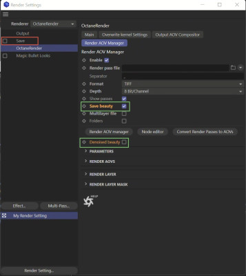

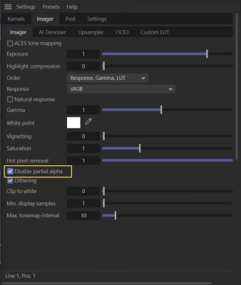

Please try to disable C4D Save options, and save your results via Render Settings/OctaneRender/Render AOV Manager tab.
You need to enable the Save Beauty option, and/or Denoised beauty option if necessary: About Straight Alpha option, in OctaneRender you need to check the "Disable partial Alpha" option in Imager node: About Picture Viewer result, try to set the View Transform popup to OFF.

Thanks for your reply. I need the C4D saver because in the Octane saver there is no possibility to export TIFF with LZW compression, which my client requires. I need to render hundreds of pictures and can not always manually save every single render in Photoshop as LZW.
Damn, good point!
Maybe you can create a Photoshop droplet to automate the compression process.
