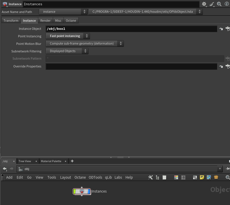

The other option is to use the houdini instance object. You can use a pointcloud with typical instancing attributes (orient, pscale, scale etc) combined with an @instance attribute which contains the path to the objects to instance (for example obj/box1) (or if just a single object you can skip the @instance attribute and just use the object parameter. Turn on "point instancing" in the instance object settings to see it in the viewport.

I am currently using the packed primitive technique, but it's proving to be quite cumbersome to use after the point count gets over a million or so. Does this instance object with "fast point instancing" technique utilize the point cloud/octane scatter under the hood? or does it make an entry in the orbx for each instance? The trouble I'm having is that I have about a 100 or so instance types, instantiated with a count of between 100,000 and 1,000,000. If I'm not mistaken, the instance object approach would require one instance node per instance type, correct?

So you don't have to setup a new instance object for each type, the points can point at different objects using the @instance attribute.
The object instance method is about twice as fast to load as the packed primitive method, which is negligible with small instance counts but can make a big difference with bigger numbers. We're hoping to improve this, but for now this is how it is.
Either form of instancing uses octane scatter under the hood, they are just extracted from Houdini in different ways, thus the performance difference.
In the meantime for very large instance counts (in the millions) i very much recommend the object instance workflow (i know its more cumbersome...)
In terms of overall performance though, having many different instance types very much increases the load on the system. And Octane currently has a limit of about 19 million instances overall if you have motion blur enabled (further depends on the motion blur sample counts too). If you can decrease instance variations, that will very much improve performance.
