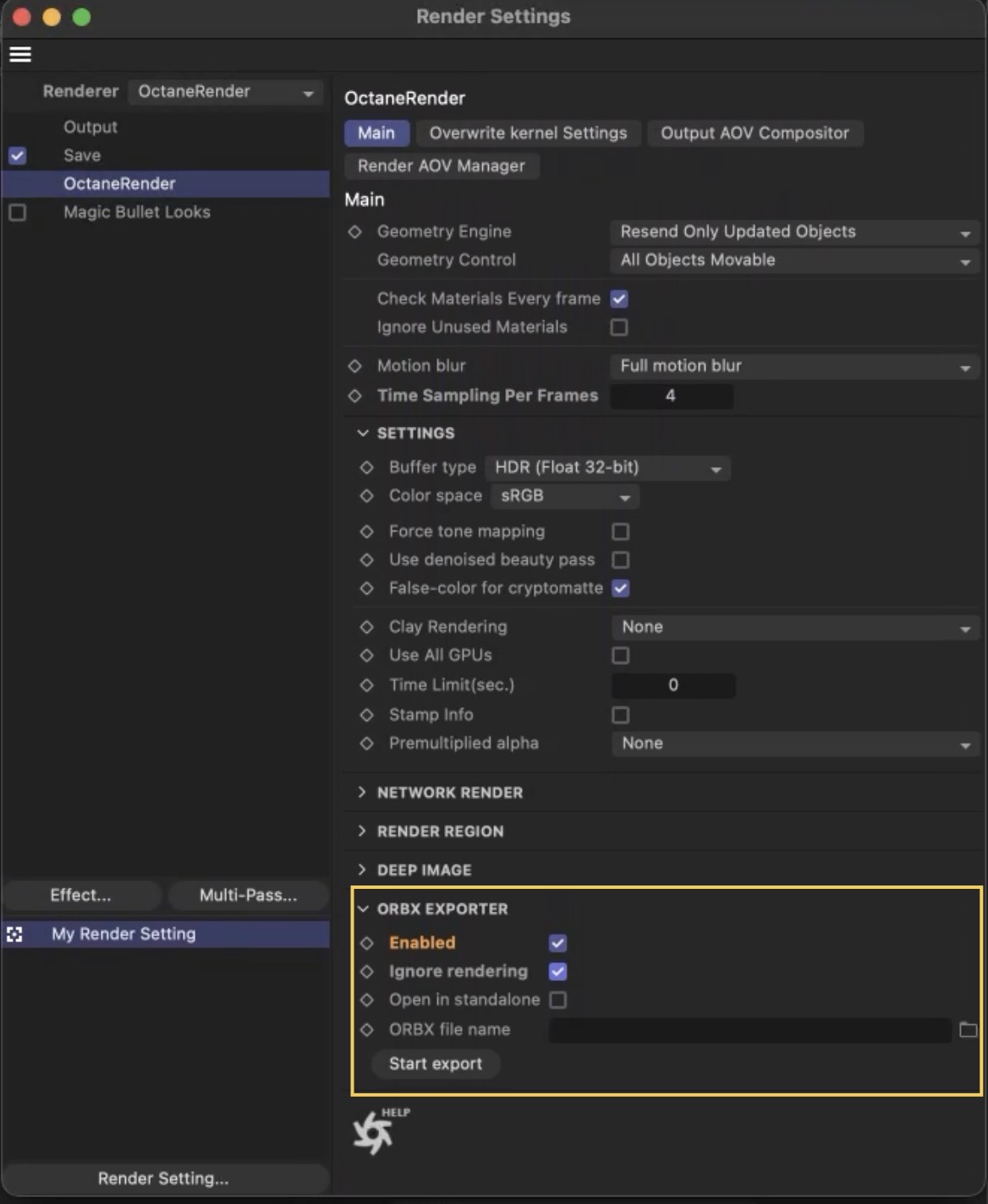

Please make sure to have not enabled the ORBX EXPORT options in Render Settings/OctaneRender/Main tab, or the scene will be saved as .orbx on your disk, instead of rendering in Picture Viewer: ciao,
Beppe
Beppe
