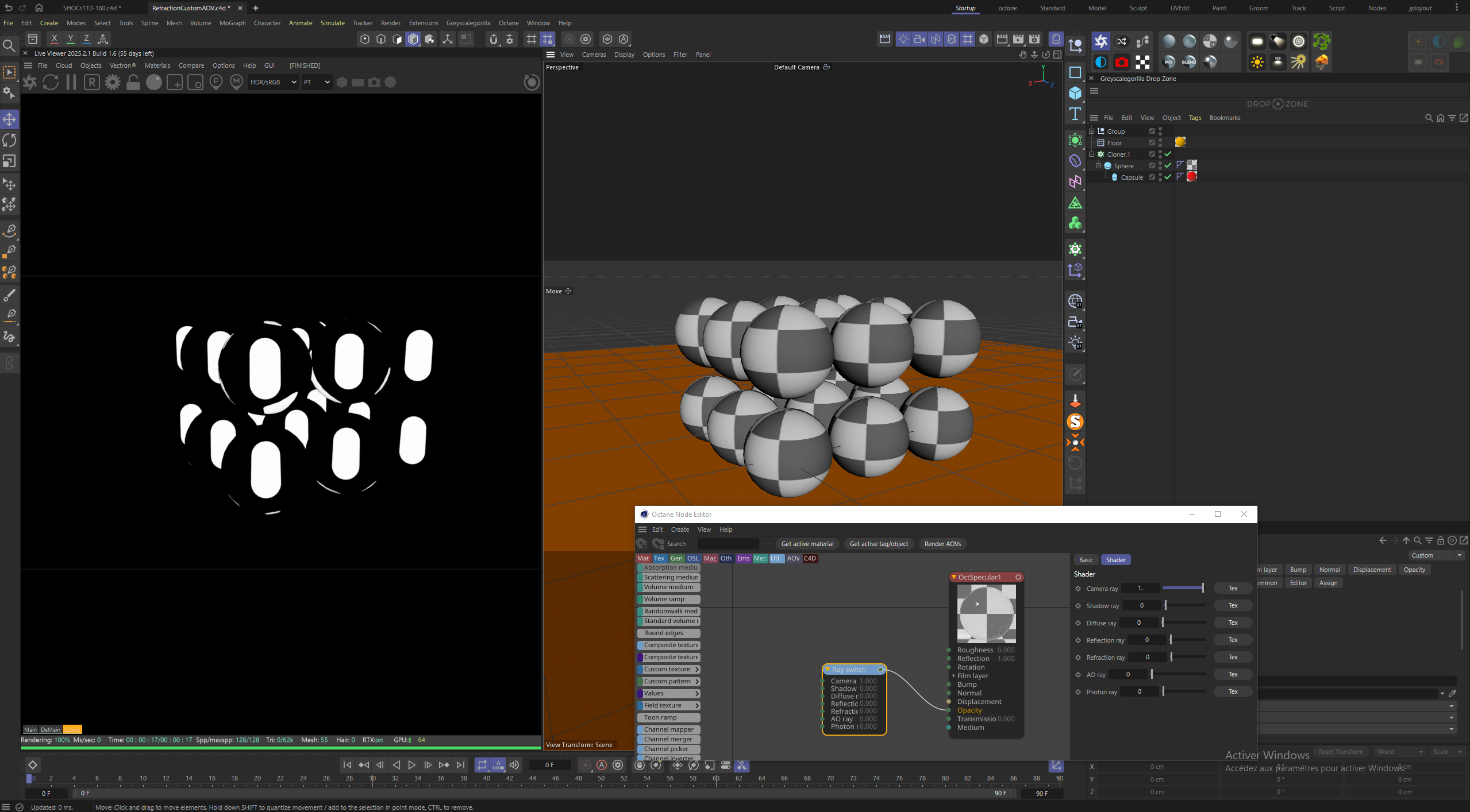

It's almost what I need. But, in my scene, I have multiple cells (cloner) and on the custom pass, there is a lot of reflexions with other cells. Il put a Ray swich node in the specular material whit all the value to 0, except for tha camera ray (1). It's better but I've got alwys some refraction. Any idea on how the achieve this? I realy need just the capsule.
Posts: 10643
Ok, just for calculating the mask, you can set the Specular Depth to 2 in Kernel panel:
ciao,
Beppe

Thank's again Beppe, but it doesn't work with a different camera angle.
Posts: 10643
Weird, it work in any direction here, with a default Specular material:
The ray should't have enough depth to show extra refraction :roll:
ciao,
Beppe

Thank you so much! You saved me!
Once again, it wasn't that complicated, but I had to figure out how to combine the different parameters to achieve my goal.
