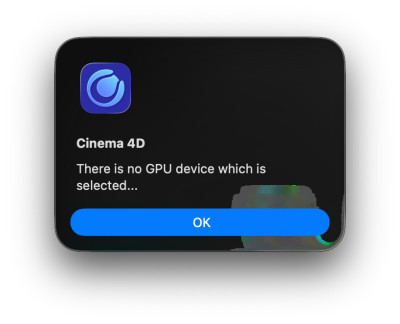

I'm having trouble with Octane and get this error when starting to render. The Cinema 4D scene is empty.

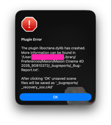

Then I get another error message, and Cinema crashes to the Desktop.

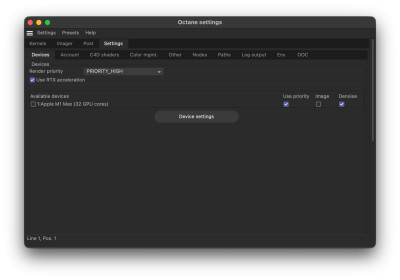

When opening the Octane Settings, the chip is by default unchecked. And if I try to check it, it doesn't change anything, and the critical error remains.

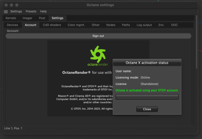

I tried logging the plugin out. But this doesn't work either, as the button is broken and doesn't do anything when pressed.
