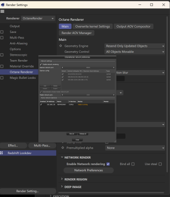

When I bring up the Octane Network Preferences from the C4D Preferences it gives me a windows that is too small to read anything. I tried changing the UI fonts in C4D preferences, but it didn't change the Network window. Is there a workaround for this?
I'm on Windows 11 with a 4K monitor. This was in C4D 2025.3.3 and Octane 2025.2.1 and Octane C4D plugin 2025.2.1 Plugin v1.6.1.

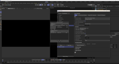

Windows was set to 200% so I set it to 150% and it made all of the fonts on my system so small I can barely read them. However, the Octane Network window is still small.

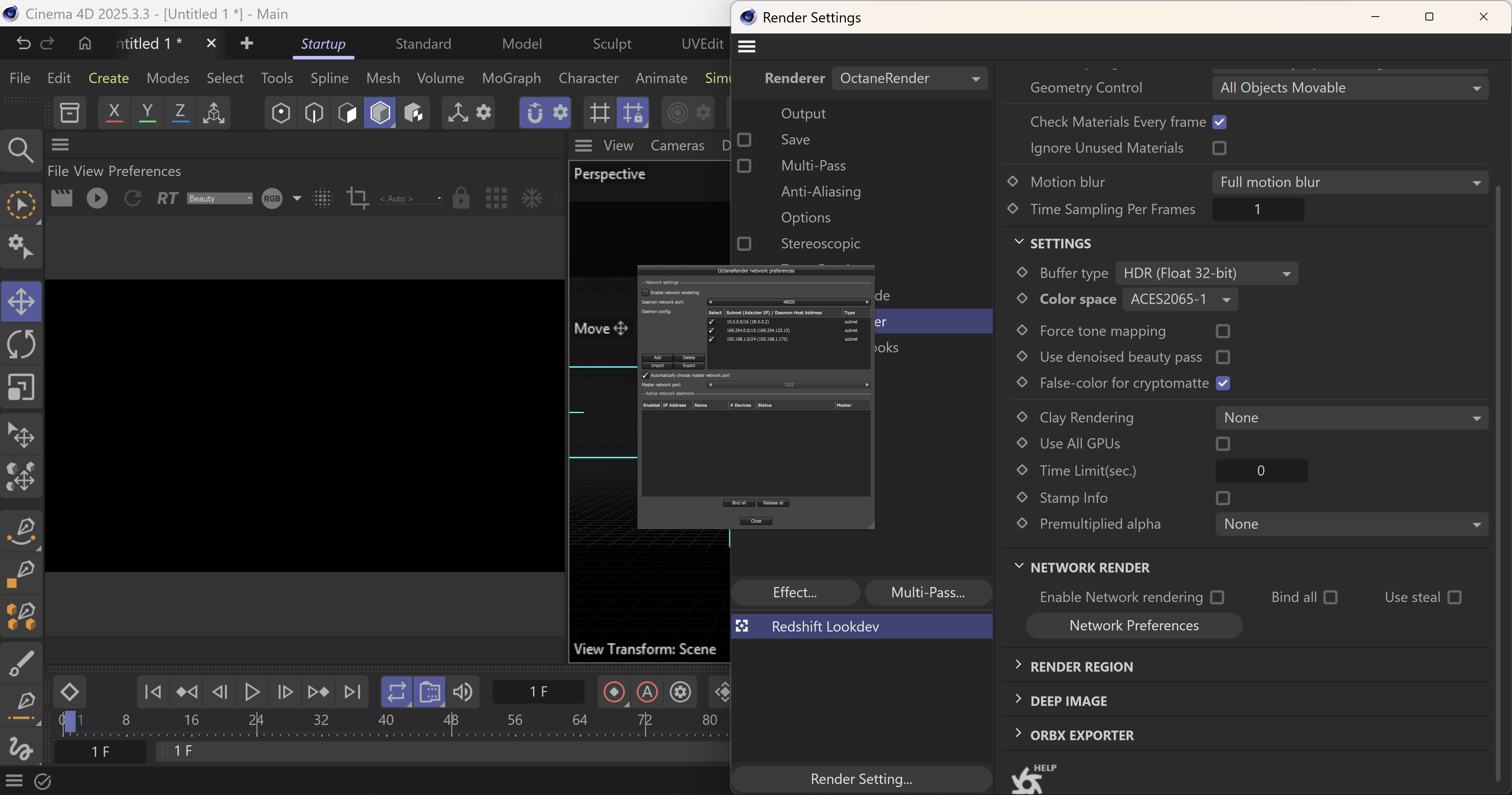

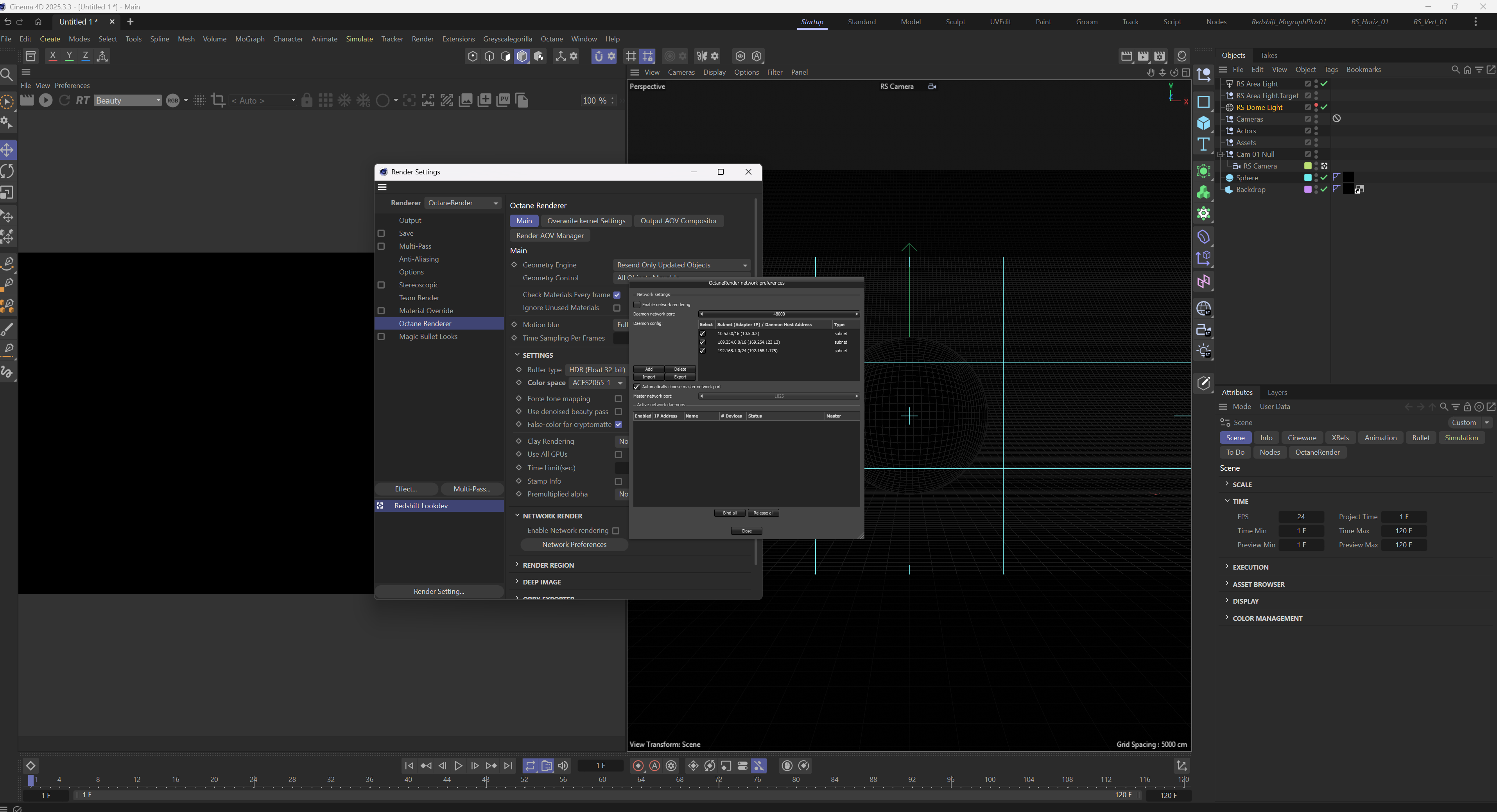

I then set C4D's font from 12 to 16 and it made C4D bigger, but Octane didn't change.
I had noticed that Windows recommended 300% font size so I tried that but it was way too big. And still, Octane didn't change in size.

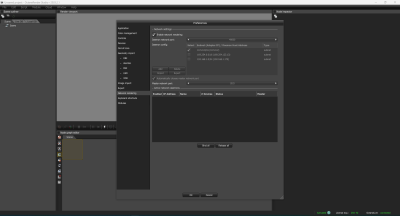

Network in Standalone looks fine, I can't find any areas where the font is too small.

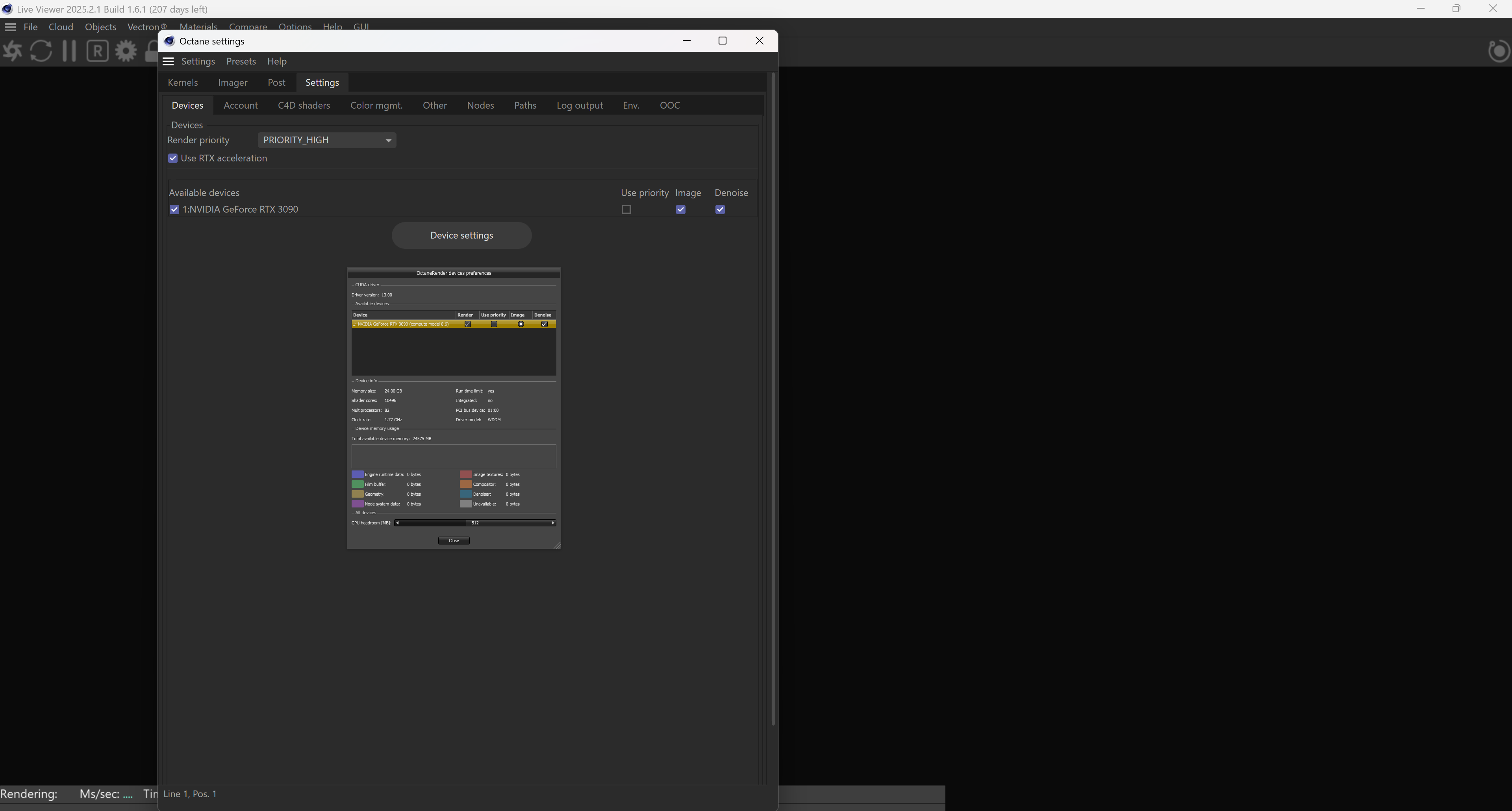

I've searched throughout C4D trying to find another window that does this and the only one I could find was also from Octane, in the Settings then Device Settings.
Another place I happened to notice this font issue is the Splash screen of Unreal, but Unreal itself is completely fine.
