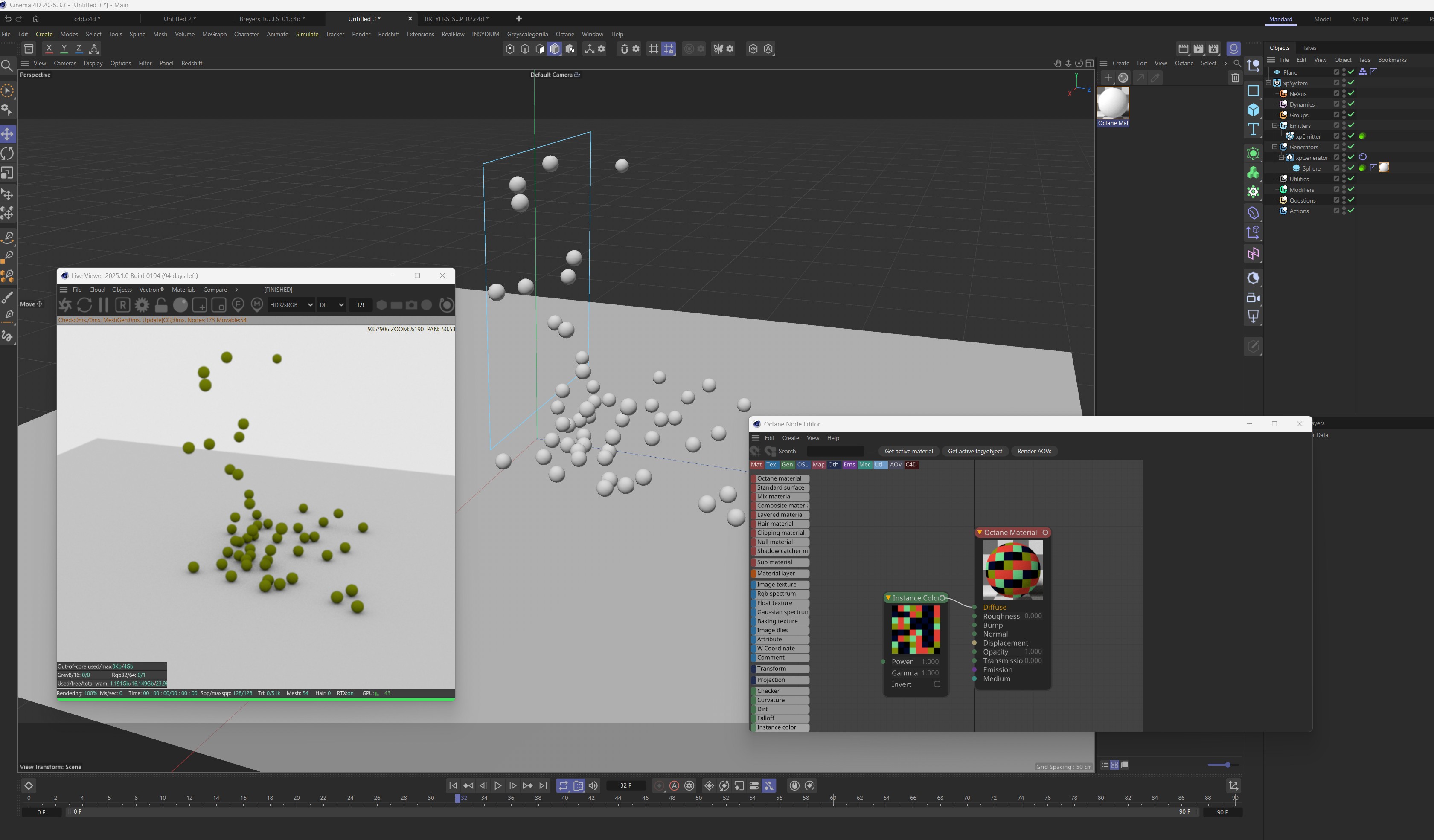

Hello! I'm having issue with the material instance node not getting random colors from xpaticles.
the issue seem to be specific to the material when applied to objects inside an xpGenerator. Not sure what is wrong.
File attached
instance_node_Xparticles_random_color_issue.zip
(166.01 KiB) Downloaded 54 times

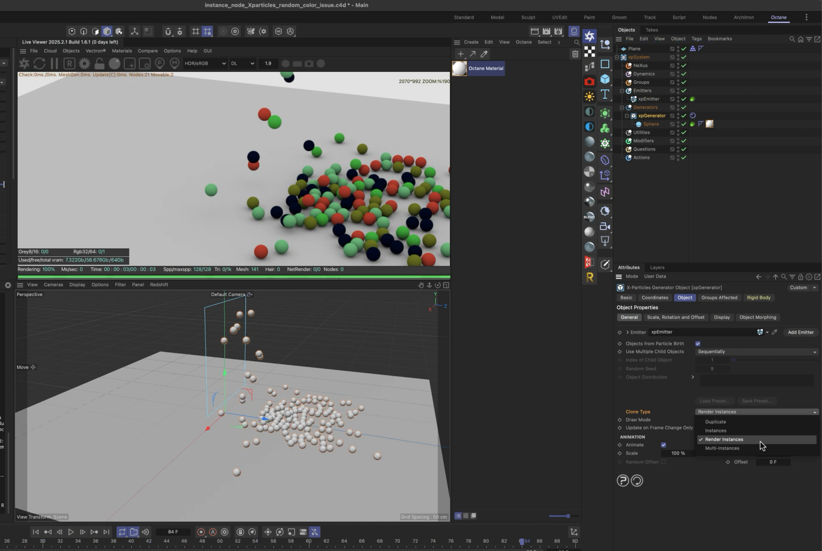

Just change the Generator "Clone type" popup to "Render Instance":
ciao,
Beppe
