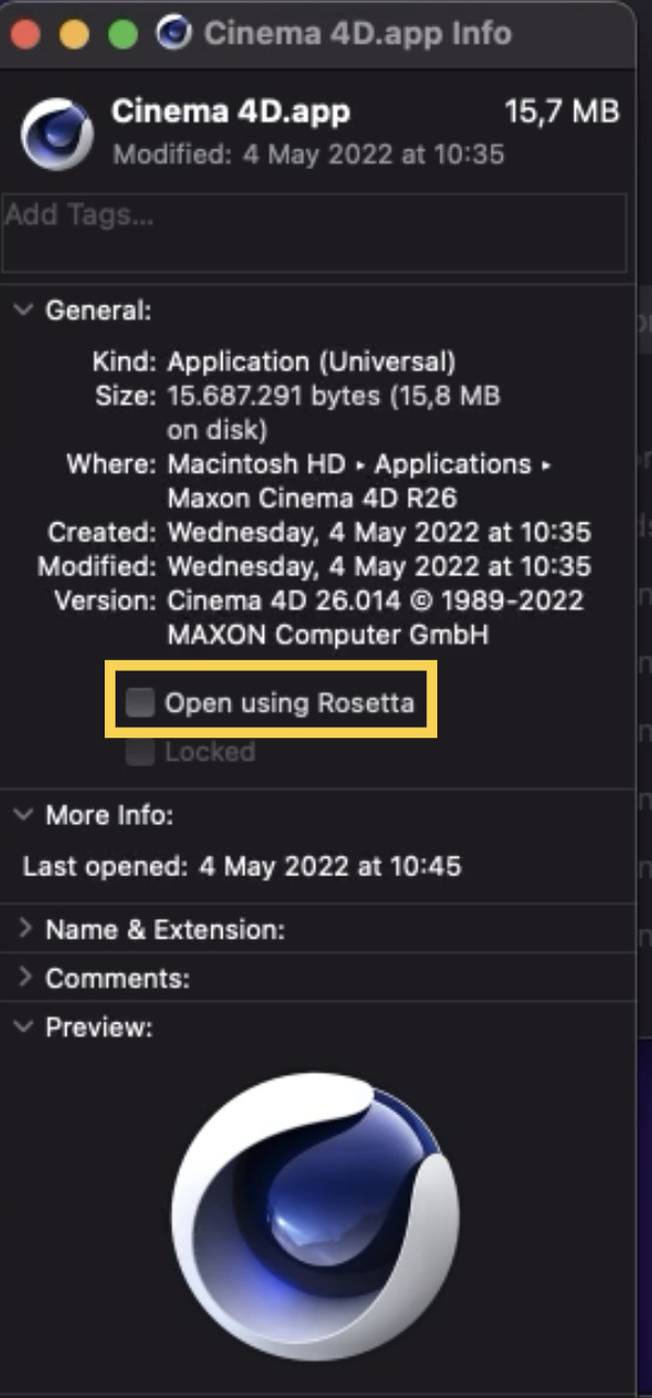

Please also make sure to have disabled the "Open using Rosetta" option in the Info panel of the Cinema 4D.app, or plugin cannot be loaded:
And to have updated Maxon C4D to a recent build, for a correct installation of OctaneRender plugin for macOS Sequoia, firstly you need to update your Maxon C4D to a recent build, (R25.117, R26.107, 2023.2, 2024.4, 2025.0.1), or plugin cannot be correctly loaded.
