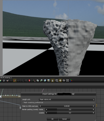

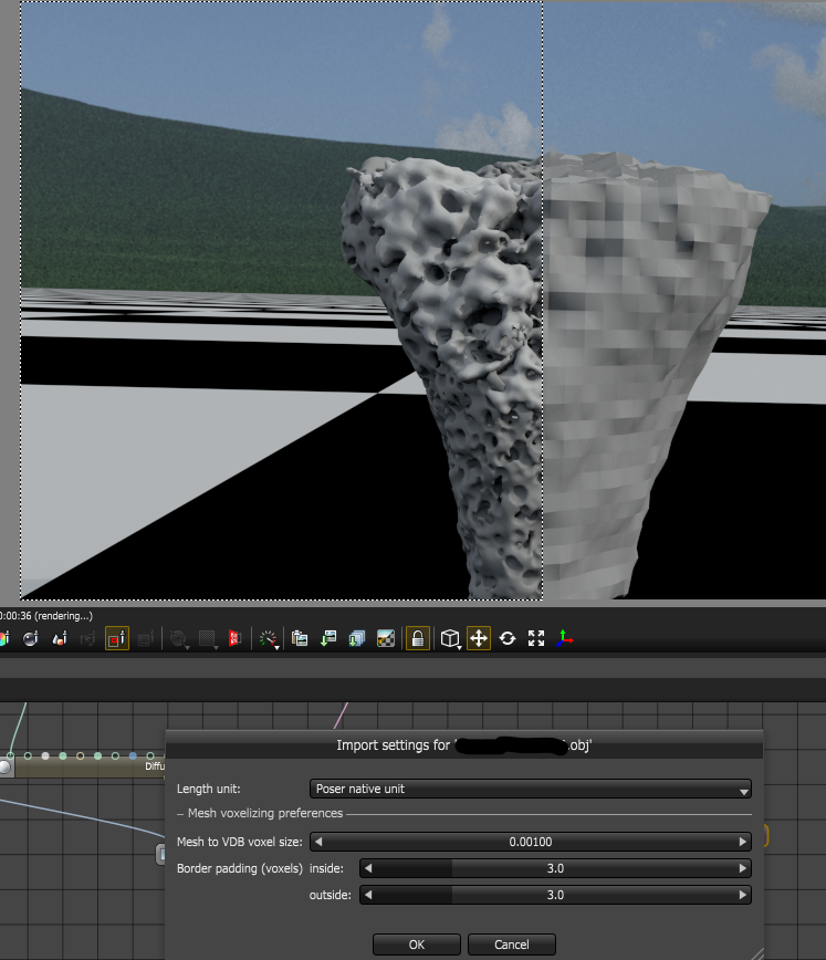

But I have a question. I tried to use an obj that is a more complex model.
But when I put it into the scene, not all the details are shown.
Even when I crank the voxel setting down. It shows up as lower quality. The normal obj is on the left of the screenshot. And the SDF import is on the right.
Am I missing something? Or does it not handle complex shapes that well?
