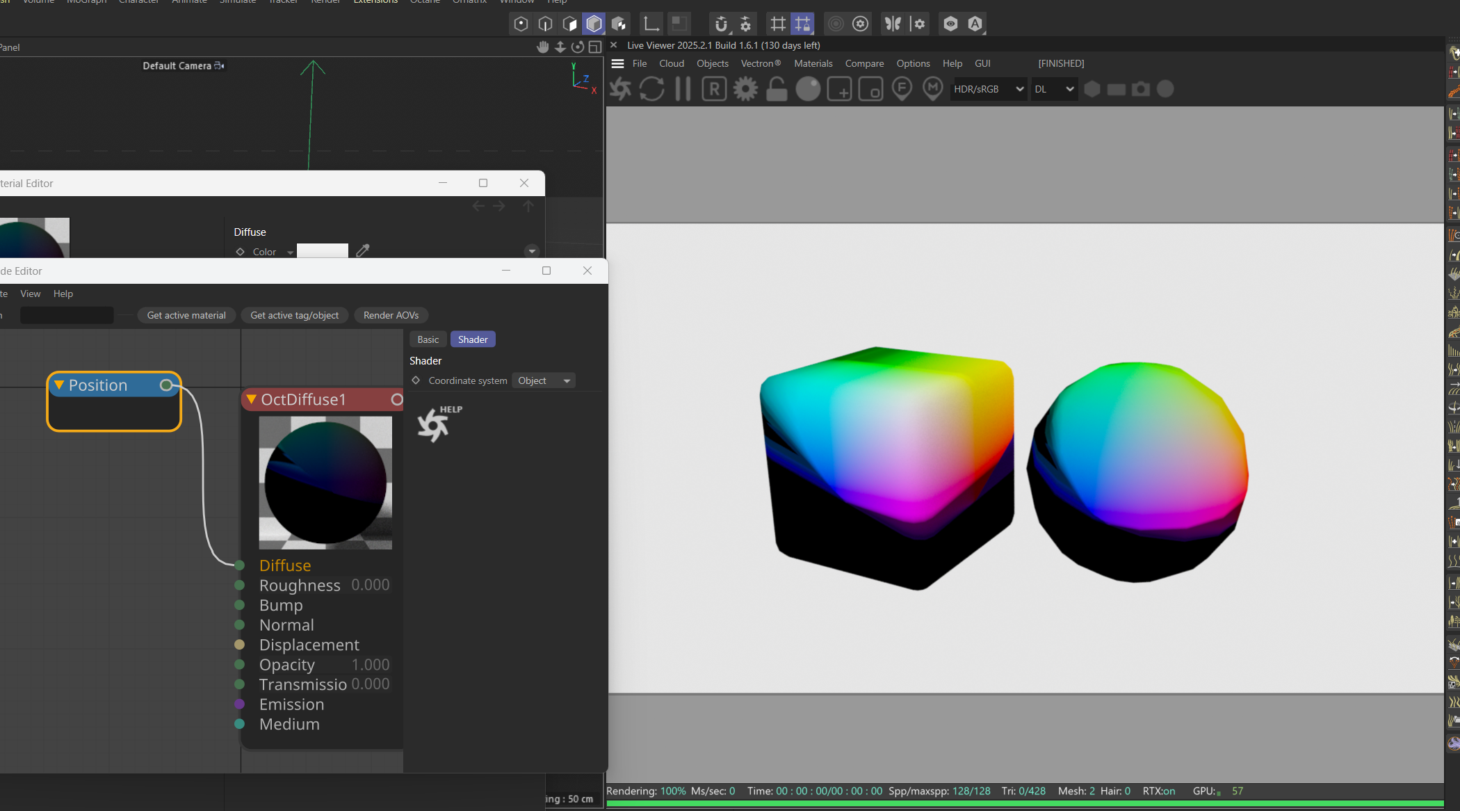

Everything is on the screenshot

Sorry, I didn't add it right away

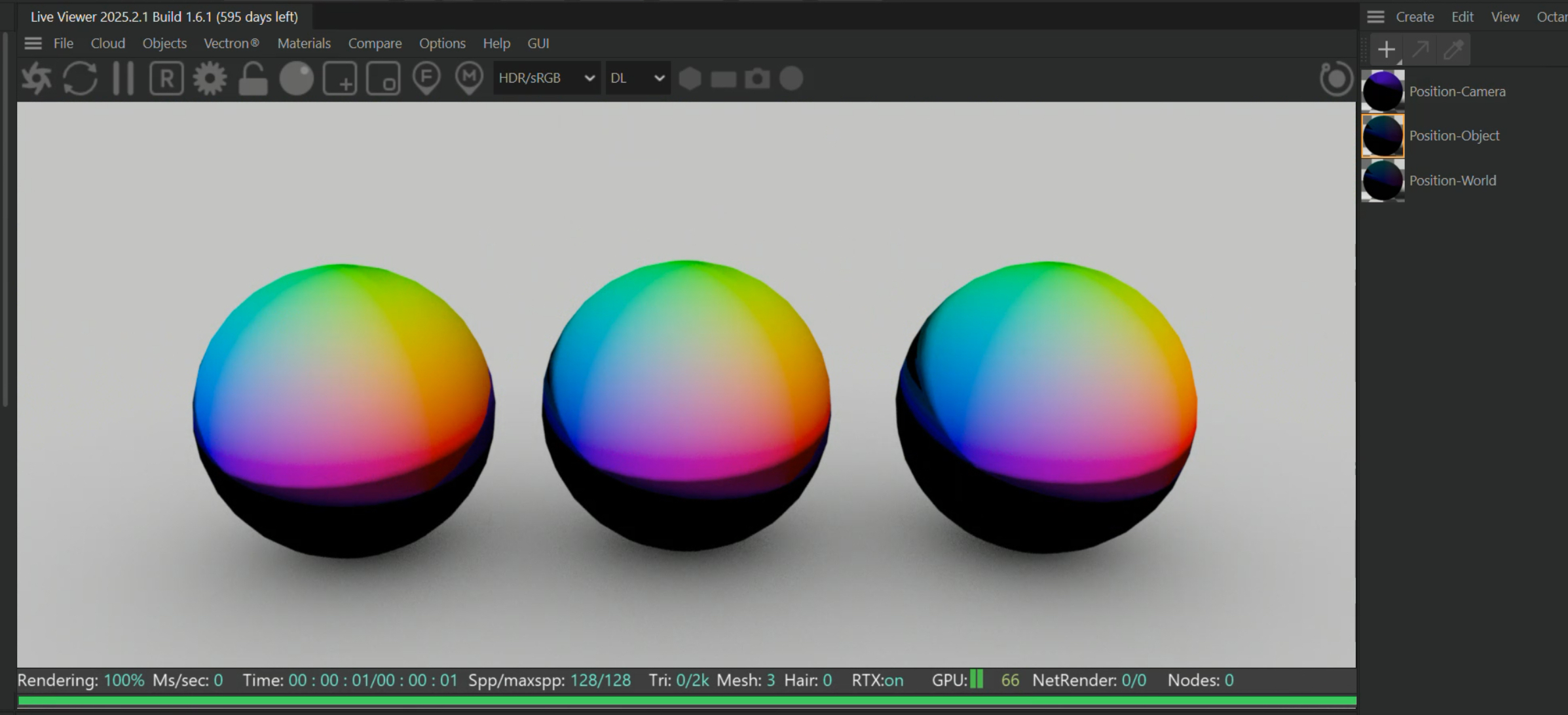

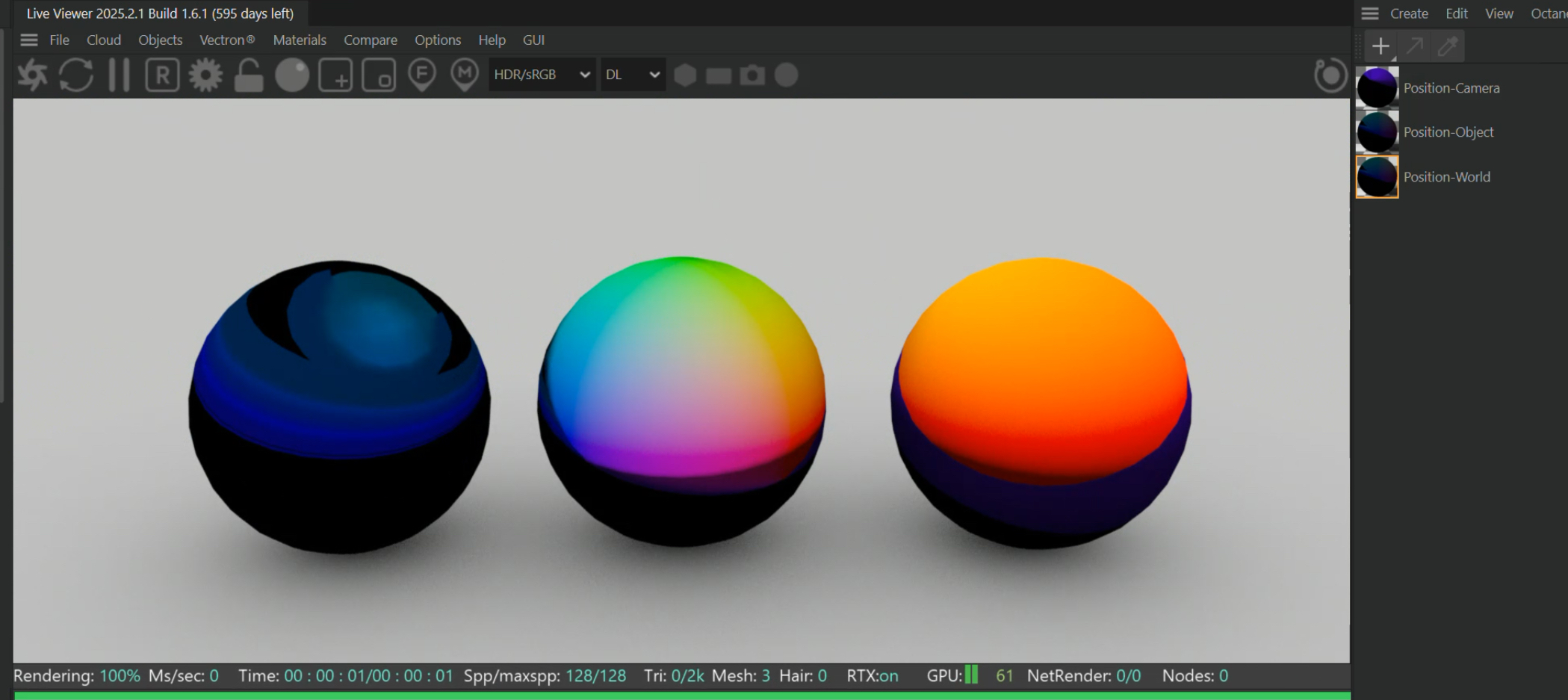

I think that you get confused because the objects are too near to the origin, so the World position is very similar to Object position.
Here are three spheres in Position World:
In Position Object:
And in Position Camera:
