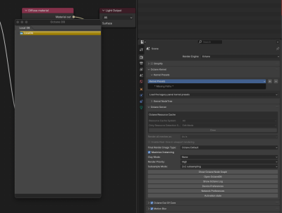

1. Kernel Presets reads "missing paths"
2. Octane DB loads nothing but the empty LocalDB folder
Screenshot shows both issues.

I don't have a mac to test the build, but the "missing paths" is just normal as long as you didn't create any preset. About the LiveDB, did you set the Path in the Octane Addon Preferences?
