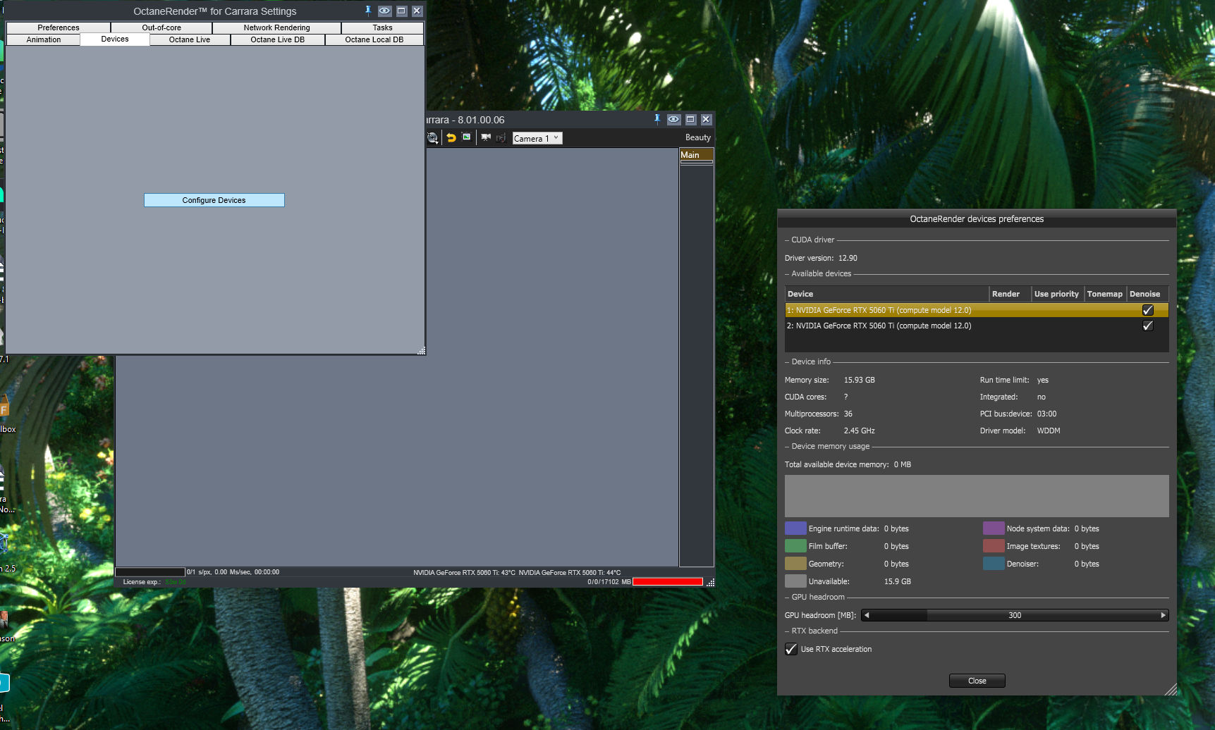

So I just upgraded to Studio 2025 today and I'm having some issues with the plugin for Carrara. When I run Octane Standalone, the program sees the GPU processors and cores as expected and allows me to select them as rendering devices. However, when I access Octane through the Carrara plug-in, the GPUs are registered, but the memory is not available on either card. I cannot select the cards for use for rendering, for some reason I can only use them for denoising. I have attached an image of my situation. I have also included my system specs. Thanks, Sighman!
* Carrara 8.5 Pro
* OctaneRender for Carrara 2020.1.00.06
* OctaneRender Studio 2025.2.1
* OS: Windows 11 Home
* CPU Intel Core i9 10900K / 3.7Ghz Boost 5.2Ghz
* Motherboard: SuperMicro C9Z490 PGW PCIE-3
* System Ram: 128gb
* GPU: 2 x PNY Nvidia RTX 5060ti
* Driver Version 576.88
