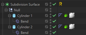

One other issue I came across today - the new Rest Position feature seems to have some limitations once Subdivision Surfaces are involved?
- If the mesh is a child of an SDS and the Rest Position tag is enabled, the mesh does not render for me.
- If the Rest Position tag is then moved to the SDS, rendering works again, but only if the mesh is the topmost and only object within that SDS. For example, if the mesh is a child of a null within the SDS, the object renders but without functioning Rest Position (tag also turns yellow).
- By extension, if there are multiple objects inside the same SDS these don’t seem to use the Rest Position, I believe? Basically the setup from the screenshot:
Even with these downsides, Rest Position is still an amazing feature to have, so no complaints. So just asking whether these are in fact current limitations - or maaaaybe there is way to get a setup like this to work? : )

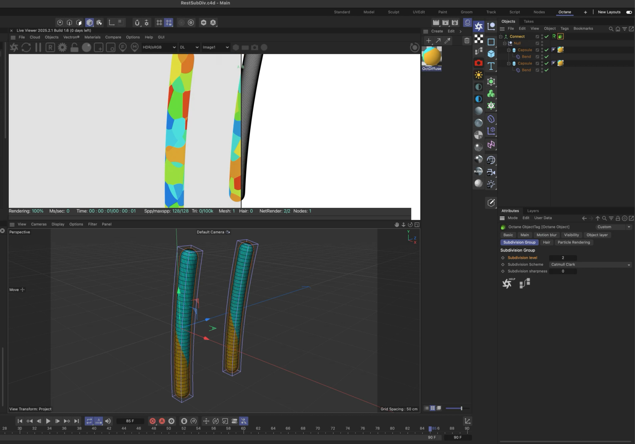

you need to use a Connect object, instead of C4D Subdivision surface, and use an Octane Object tag to add subdivisions only at render time:
RestSubDiv.c4d.zip
(169.07 KiB) Downloaded 105 times
