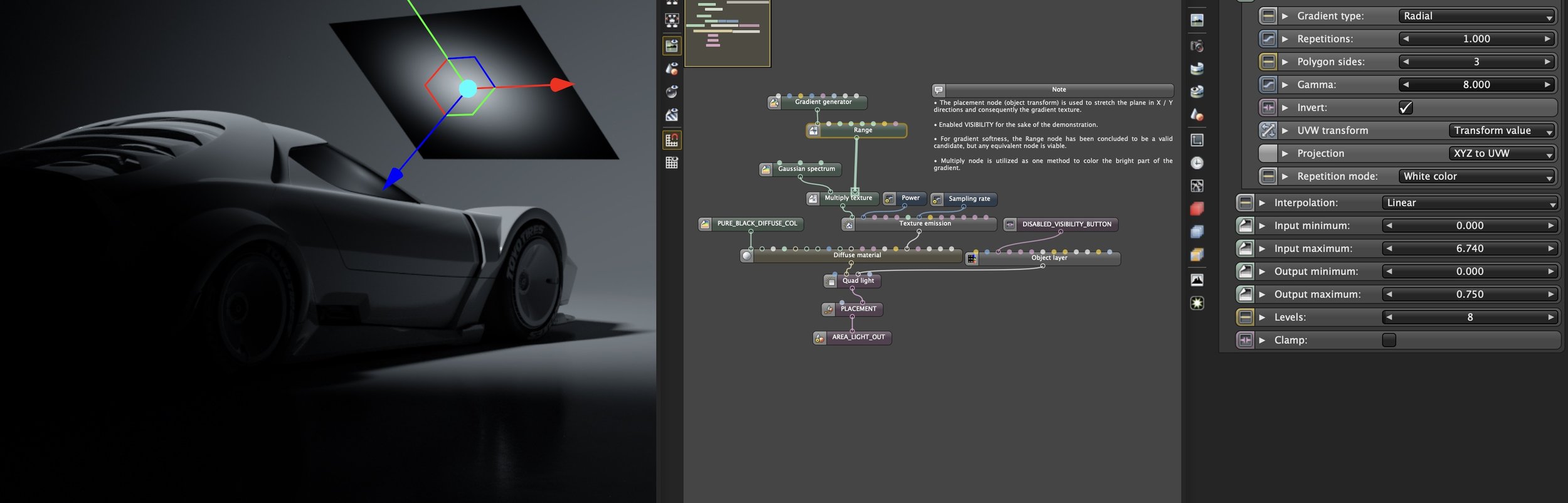

One [upgrade] specifically for light would be a bonus since it's currently straightforward to setup once-and-for-all, subsequently saved as a preset, as a single gradient light of some sort or a whole kit with variants (as shown).
This light setup (link to the page) can be saved as an ORBX preset in Standalone (equivalent workflow in plugins).
A gradient node overhaul would be usable beyond lighting, and perhaps more beneficial for the larger crowd.

While this isn't 3ds Max specific and improving on that particular user experience, it's an early attempt at providing some presets for designing studio looking lights.
The page contains the information and URLs for ORBX download.
More appealing render previews on the page.
