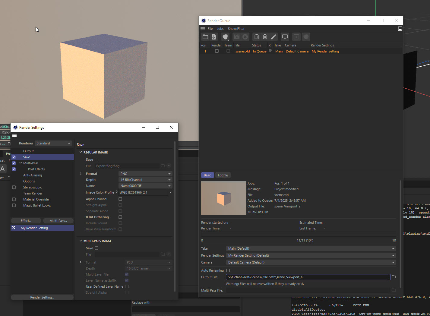

Hello, I have long term problem with octane, specifically with the render settings out there... If I would like to use only the Octane output specified in the Octane render settings / Render AOV group and for such a reason I do uncheck the C4D's Save/Regular Image... To not render anything else I really need and want (Octane Renderer/Render AOV group /Render pass file) I get unexpected exported files on unexpected locations (beside the original C4D project file).
So When I uncheck the Render settings/Save/Regular Image and leave just the output specified in Octane Renderer/Render AOV group (Save beauty) I get exported images also on unspecified location right beside the original project file... It is weird, Do you know about this issue?
Please let me know, I have found there in the documantation that I should only use the Octane Renderer Output for Beauty pass and everything else, but it causes this problem with duplicating output images.
When I use only the Octane output specified in octane render setting and I uncheck C4D's Save / Regular Image I get...2x
