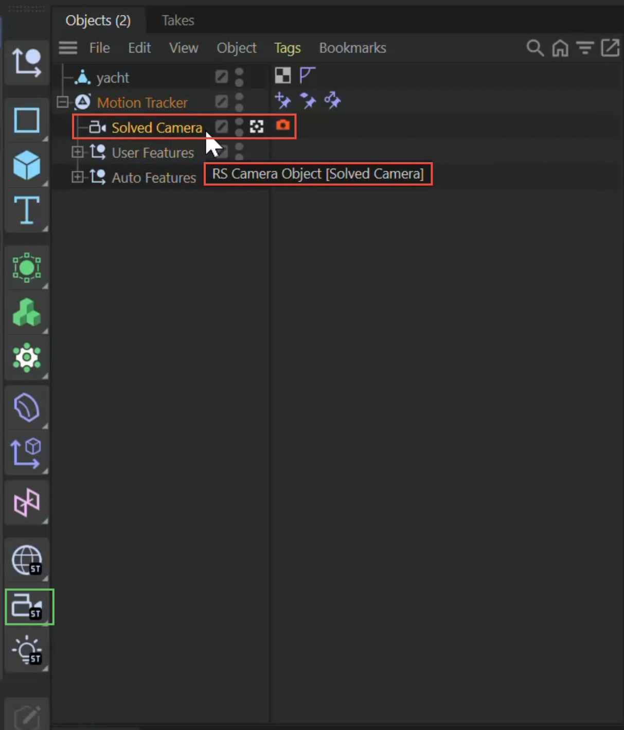

The issue is that the Solved Camera is a RedShift Camera, that is not supported yet.
You need a Standard C4D Camera to make it works without issues, note the "ST" text in the icon:
The workaround is to create a new Octane Camera at first frame, set the Focal Length to 25.248, and place it as a child of the solved camera:
