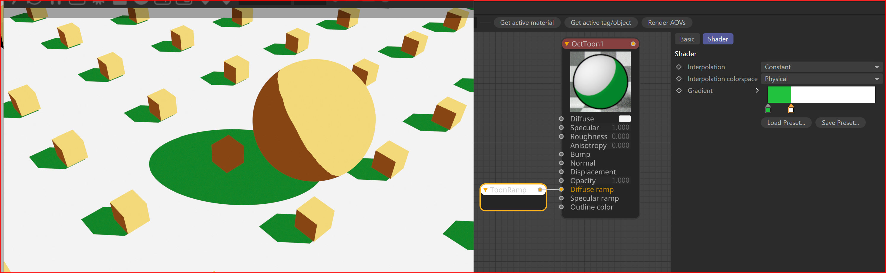

If I understand your question, shadow color is controlled by the diffuse ramp of the Toon Material being shadowed; at least that's how I've done it the few times I've needed toon shading. It's not specifically a shadow color, so much as it is the color of the surface when weakly illuminated, regardless of whether that illumination is direct or indirect. In this quick example, the shadows on the ground are green because the low end of the Toon Material's Diffuse ramp is set to that color.
