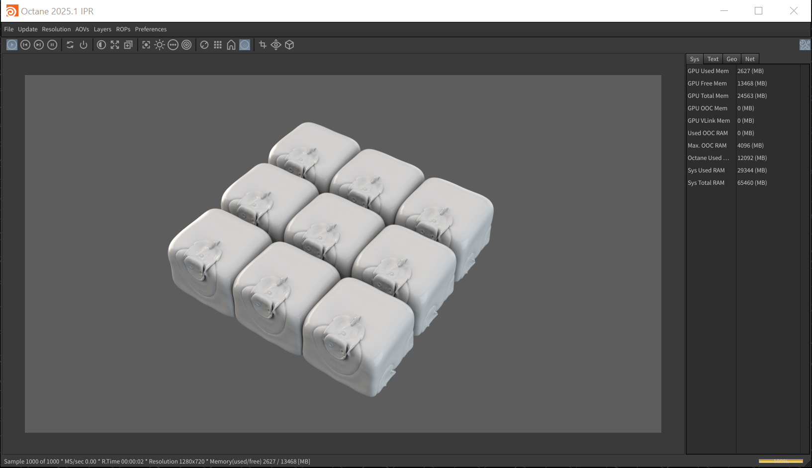

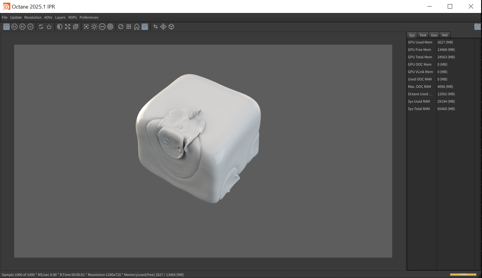

Here you can see that a single item and instances have the same usage (2627mb)

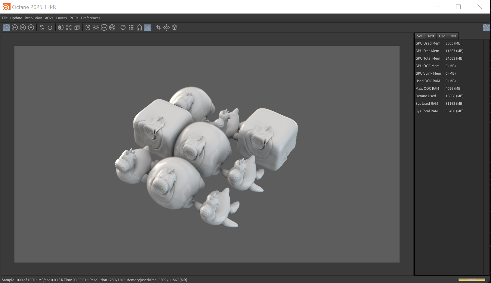

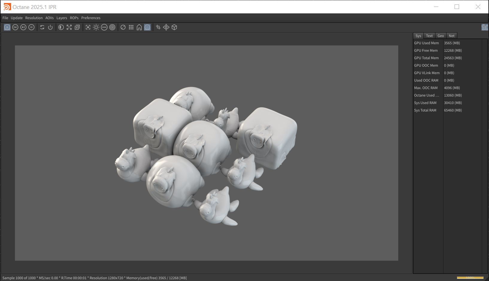

Time offsetting yields the same as unpacked. (3565mb)

So the thing is that octane only loads the geo of the CURRENT FRAME into the GPU, not the WHOLE frame range of the instances. So if every instance is at a different time offset there is no benefit to be had.
But as soon as multiple instances are on the same frame, then you get memory benefits.
